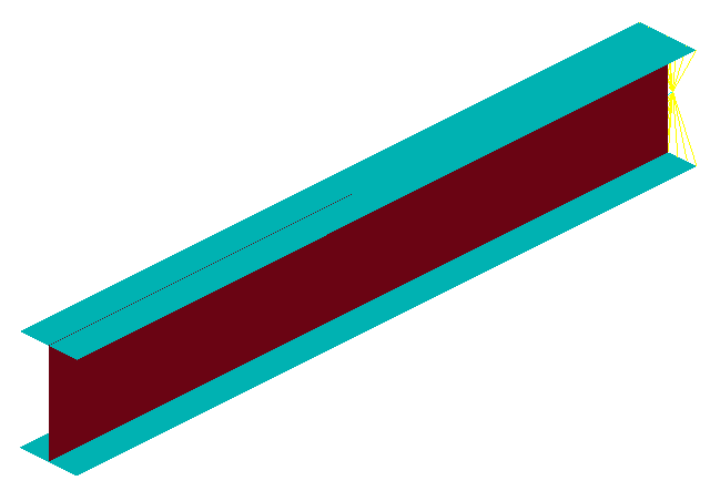

  • Import a model to HyperLife
  • Select the SN module and define its required parameters
  • Create and assign a material
  • Assign load histories for scaling the stresses from FEA subcases
  • Evaluate and view results
Before you begin, copy the file(s) used in this tutorial to your working directory.
Import the Model
  1. From the Home tools, Files tool group, click the Open Model tool.
  2. From the Load model and result dialog, browse and select HL-1020\Ibeam.h3d for the model file.
    The Load Result field is automatically populated. For this tutorial, the same file is used for both the model and the result.
  3. Click Apply.

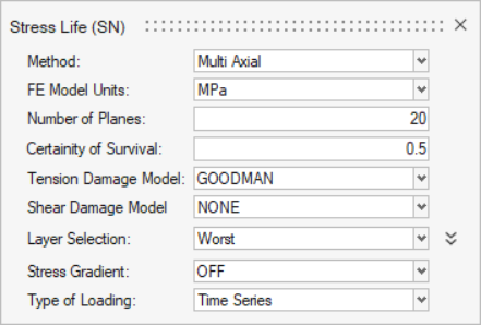

  2. Define the SN configuration parameters.
    1. Select Multi Axial as the method.
    2. Select MPa for the FE model units.
    3. Enter a value of 20 for the number of planes.
    4. Enter a value of 0.5 for the certainty of survival.
    5. Select GOODMAN for the Tension Damage Model.
    6. Select NONE for the Shear Damage Model.
    7. Select Worst for the layer selection.
    8. Select Time Series for the type of loading.
    Figure 4.

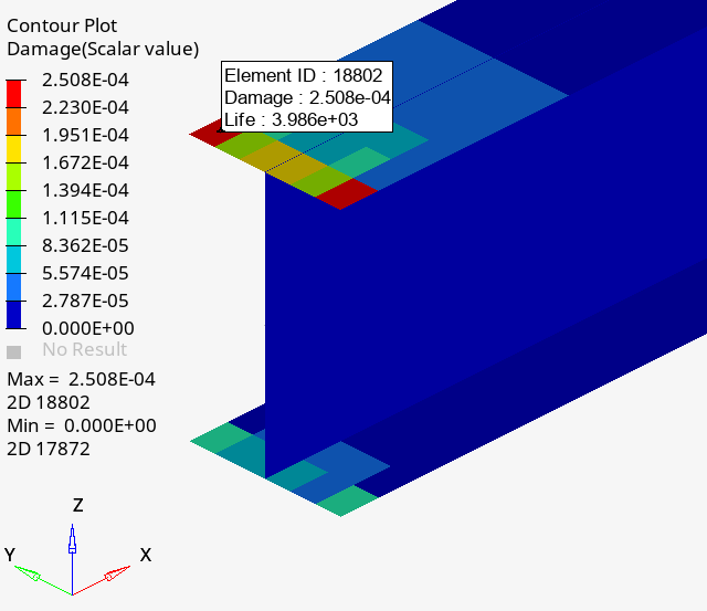

    The contour below highlights the total damage (Event 1 + Event 2).
    Figure 16.
    Figure 17. Event 1: Damage matrix for element 18802
    Figure 18. Event 2: Damage matrix for element 18802
