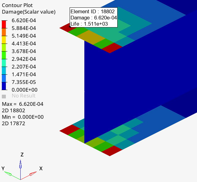

    The contour below highlights the total damage (Event 1 + Event 2).
    Figure 16.
    Figure 17. Event 1: Damage matrix for element 18802
    Figure 18. Event 2: Damage matrix for element 18802
