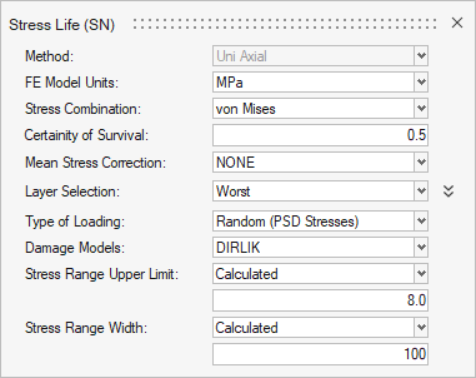

Define the Fatigue Module
  1. Click the SN tool.
    The SN tool should be the default fatigue module selected. If it is not, click the arrow next to the fatigue module icon to display a list of available options.
    Figure 5.
    The SN dialog opens.
  2. Define the SN configuration parameters.
    1. Select Uni Axial as the method.
    2. Select MPa for the FE model units.
    3. Enter a value of 0.5 for the certainty of survival.
    4. Select NONE for the mean stress connection.
      Note: Mean stress correction is only applied if a static subcase is to be added in the Event.
    5. Select Worst for the layer selection.
    6. Select Random (PSD Stresses) for the type of loading.
      von Mises is automatically selected as the stress combination.
      Note: For Random Fatigue with the SN module, Abs Max Principal is also available from the drop-down. For EN, only the von Mises stress combination is supported.
    7. Accept the default random response values.
      Stress Range Upper Limit (Calculated): Calculates the upper limit of the stress range. This is calculated as 2*RMS Stress*factor (Default factor = 8). The RMS stress is output from the random response subcase. The stress ranges of interest are limited by the above calculated stress. Any stresses beyond the calculated value are not considered in random fatigue damage calculations. Upper stress range can also be input directly via the User Input option.
      Stress Range Width (Calculated): Calculates the width of the stress range for which the probability is calculated. The default is 100 and the first bin starts from 0.0 to the calculated width. The width of the stress range is calculated as the upper limit of the stress range / Stress Range Width (Calculated). The stress range width can also be input directly via the User Input option.
    Figure 6.
  3. Exit the dialog.

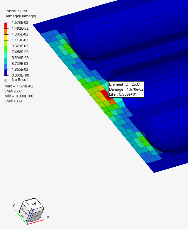

Evaluate and View Results
  1. From the Evaluate tool group, click the Run Analysis tool.
    Figure 12.
    The Evaluate dialog opens.
    Figure 13.
  2. Optional: Enter a name for the run.
  3. Click Run.
    Result files are saved to the home directory and the Run Status dialog opens.
  4. Once the run is complete, click View Current Results.
  5. Use the Results Explorer to visualize various types of results.
    Figure 14.
    Figure 15.
