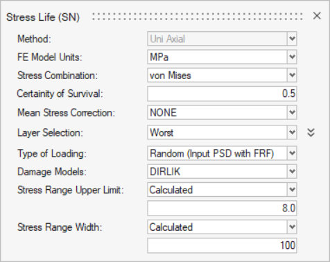

Define the Fatigue Module
  1. Click the SN tool.
    The SN tool should be the default fatigue module selected. If it is not, click the arrow next to the fatigue module icon to display a list of available options.
    Figure 5.
    The SN dialog opens.
  2. Define the SN configuration parameters.
    1. Select Uni Axial as the method.
    2. Select MPa for the FE model units.
    3. Enter a value of 0.5 for the certainty of survival.
    4. Select NONE for the mean stress connection.
      Note: Mean stress correction is only applied if a static subcase is to be added in the Event.
    5. Select Worst for the layer selection.
    6. Select Random (Input PSD with FRF) for the type of loading.
      von Mises is automatically selected as the stress combination.
      Note: For Random Fatigue with the SN module, Abs Max Principal is also available from the drop-down. For EN, only the von Mises stress combination is supported.
    7. Accept the default random response values.
      Stress Range Upper Limit (Calculated): Calculates the upper limit of the stress range. This is calculated as 2*RMS Stress*factor (Default factor = 8). The RMS stress is output from the random response subcase. The stress ranges of interest are limited by the above calculated stress. Any stresses beyond the calculated value are not considered in random fatigue damage calculations. Upper stress range can also be input directly via the User Input option.
      Stress Range Width (Calculated): Calculates the width of the stress range for which the probability is calculated. The default is 100 and the first bin starts from 0.0 to the calculated width. The width of the stress range is calculated as the upper limit of the stress range / Stress Range Width (Calculated). The stress range width can also be input directly via the User Input option.
    Figure 6.
  3. Exit the dialog.

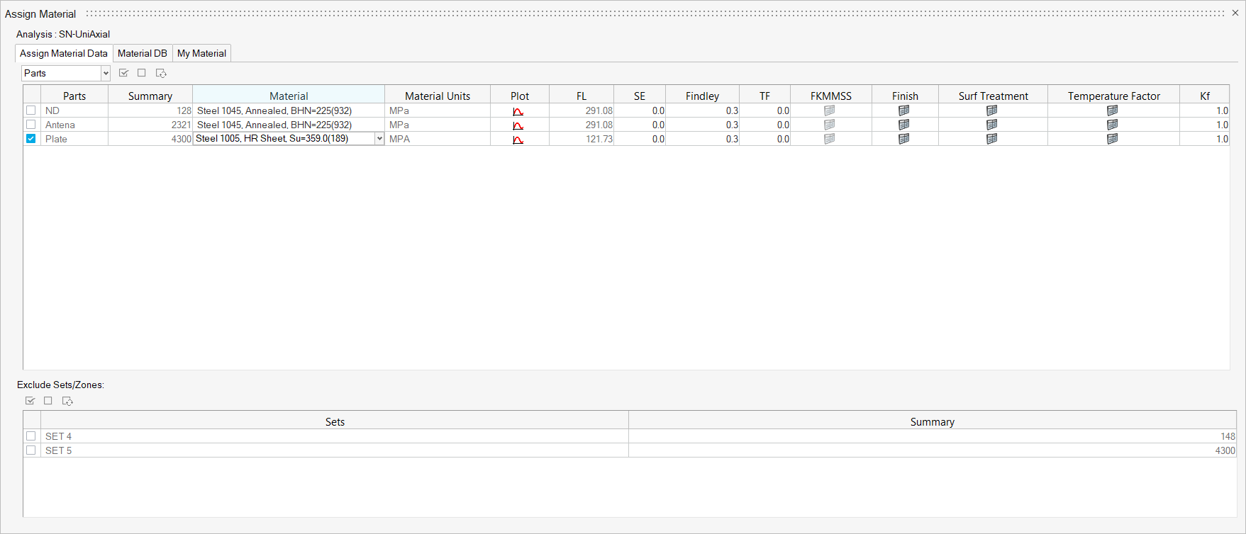

Assign Materials
  1. Click the Material tool.
    Figure 7.
    The Assign Material dialog opens.
  2. Activate the checkbox next to Plate.
  3. Select a material.
    1. Click the Material DB tab.
    2. In the Search field, enter 189 and press Enter.
    3. From the search results, right-click Steel 1005, HR Sheet, Su = 359.0(189) and select Add to Assign Material List from the context menu.
  4. Return to the Assign Material Data tab. Using the Material drop-down menu, select Steel 1005, HR Sheet, Su = 359.0(189) for Plate.
    The Material list is populated with the materials selected from Material Database and My Material.
    Figure 8.
  5. Exit the dialog.

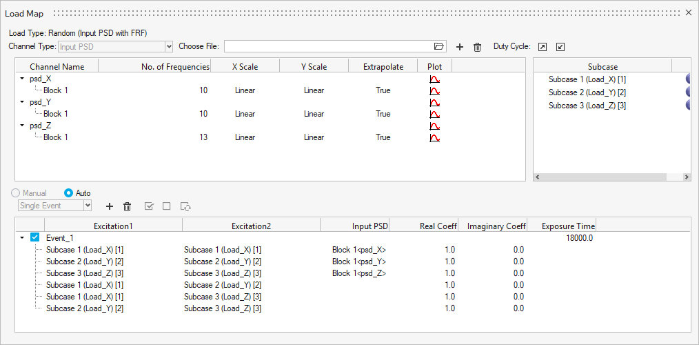

  1. Click the Load Map tool.
    Figure 9.
    The Load Map dialog opens.
  2. From the Channel Type drop-down menu at the top of the dialog, select Input PSD: Real & Imaginary.
  3. Load PSD vs Frequency data (input PSD that is to scale the FRF stresses).
    1. Click in the Choose File field and browse for psd_X.csv, psd_Y.csv, and psd_Z.csv.
    2. Click to add the load case.
  4. Optional: Click to view a plot of the loads.
  5. Select Subcase 1 (Load_X), Subcase 2 (Load_Y), and Subcase 3 (Load_Z).
  6. On the bottom half of the dialog, click to create an Event_1 header.
    The possible correlations of Subcase 1, Subcase 2, and Subcase 3 are listed under the event.
  7. Select the three psd files and drag-and-drop them into the Event header.
    Note: Any blank correlations are not considered in the calculation.
    The following pairs are created:
    • Subcase 1 with psd_X
    • Subcase 2 with psd_Y
    • Subcase 3 with psd_Z
    The remaining correlations are left blank.
  8. Activate the Event_1 checkbox.
  9. Set the Exposure Time for the event to 18000.
    Figure 10.
  10. Exit the dialog.

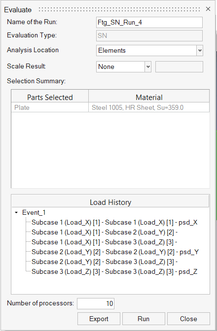

  1. From the Evaluate tool group, click the Run Analysis tool.
    Figure 11.
    The Evaluate dialog opens.
  2. Optional: Enter a name for the run.
    Figure 12.
  3. Click Run.
    Result files are saved to the home directory and the Run Status dialog opens.

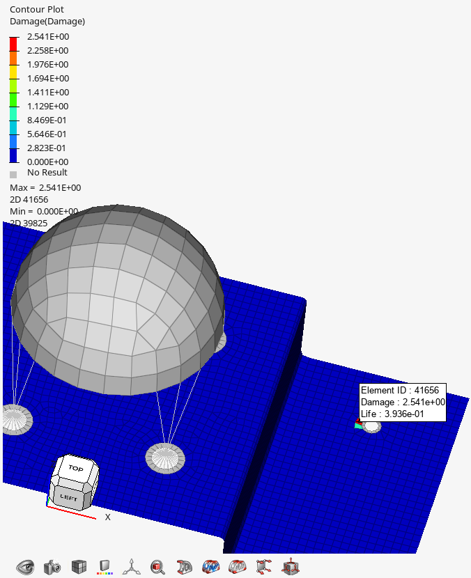

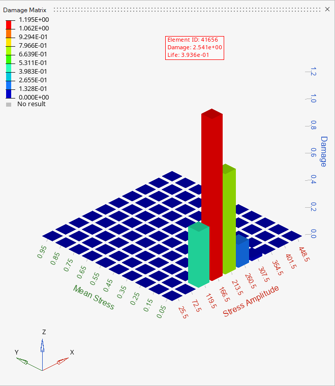

  4. Once the run is complete, click View Current Results.
  5. Use the Results Explorer to visualize various types of results.
