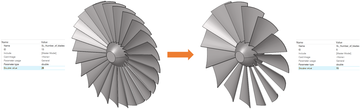

It is often required to make CAD design changes as part of an optimization or design study. Making such changes to the original CAD files often requires scripting and customization. Inspire/CATIA/NX parameters can now be easily modified directly in HyperMesh. The changes made to the CAD file in Inspire/CATIA/NX are saved and automatically reloaded. A valid Inspire/CATIA/NX installation and license are required.

Live Parameter Update
If you set the preference to allow immediate updates, changing any relevant parameter values (from within EE, via a script, and so forth) will immediately execute the update operation. If the CATIA/NX update operation is successful, the original CATIA/NX file is overwritten and parts associated with the modified parameter are purged and reloaded.
Delayed Parameter Update
If you set the preference to not allow immediate updates, changing any relevant parameter values (from within EE, via a script, and so forth) will not execute the update operation. Instead, you can use the CAD update tool to update parameters when necessary.
Results
After performing the update operation, the modified CATIA/NX CAD file is reloaded into HyperMesh. Also, a cad_updated.msg file is created in the HyperMesh start directory, which contains details about the update operation.
