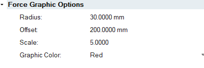

Scale Enter a real number greater than zero to define the length per unit force of the graphics. For example: At t = 2.0 sec, if the FZ of the contact patch force is 1000 N, a scale of 5 would result in the graphic vector length = 1000 / 5.0 = 200 mm.
Radius Enter a real number greater than zero giving the radius of Force Graphic Arrow.
Offset Enter a real number giving the distance out board (laterally away from the vehicle center-line) of the tire contact patch to display the tire force graphics.
Graphics Color Tire Force Arrows color. The color is used for the FX, FY, and FZ Vectors.
