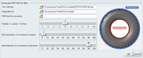

The tab contains the following:
Control Description
Generate Files
Tire CAD file
CAD geometry file of the tire for meshing. The tire geometry should be positioned such that the tire center is at Global Origin [0,0,0]. Default – refers to the file in the [GEOMETRY] section of .fxt file.
Output file Dir
Directory to output mesh files that is generated. Defaults to the .fxt file location.
PM flextire convertor
Select the STPtoOBJ.exe in the Pratt-Miller software install location.
Fidelity
Controls the coarseness of the mesh.
Tolerance relative to minimum radius (%)
Maps to the “-tol” flag used by STPtoOBJ.exe to identify boundary condition nodes at the minimum radius location.
Belt radius relative to largest radius (%)
Maps to the “-dbelt” parameter used to create the inside elements for carcass definition.
Note: Refer to the PM-FlexTire User Manual for additional details about the -tol and -dbelt parameters.
Upon clicking OK, the mesh files are generated and listed in the panel.
Output file Dir Directory to output mesh files that are generated. Defaults to the .fxt file location. The space below displays the bdf/obj/off files if found in this directory. The file names have to match with the *.fxt file name. There are three off files (*_bead.off, *_belt.off, *_inside.off) necessary to transfer the tire to EDEM. The list is automatically populated after the mesh is generated.
