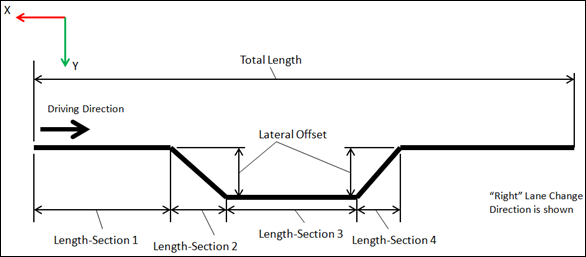

Figure 1. Double Lane Change - Path
Parameter Name Description
Units Describes the Length, Velocity, and Acceleration units.
  • Length (Model, m, ft)
  • Velocity (Model, m/s, km/h, mph).
  • Acceleration (Model, m/s2, g’s).
Lateral offset Offset distance of the double lane change.
Length- Section 1 Length of the initial straight section of road.
Length- Section 2 Longitudinal length of the initial lane change section of road.
Length- Section 3 Length of the center straight section of road.
Length- Section 4 Length of the second lane change section of road.
Length- Section 5 Length of the recovery section of road.
Minimum Radius Minimum turn radius for the vehicle while transitioning between sections (applicable for Driver type = Leaning).
Velocity The initial speed of the vehicle.
Turn direction Direction the vehicle turns during the event (as seen by the driver).
