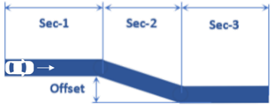

Figure 1. Single Lane Change - Path

Lateral offset Offset distance of the lane.
Length- Section 1 Length of the initial straight section of road.
Length- Section 2 Longitudinal length of the initial lane change section of road.
Length- Section 3 Length of the recovery straight section of road.
