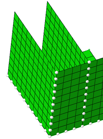

  3. Activate the Quick Find Coincident Nodes option and click Apply.
    The nodes that are disconnected display.

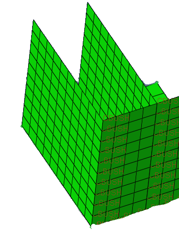

  4. Activate the Create Between Disconnected option and click Apply.
    0D elements are created.
  5. Click Cancel to delete the created elements that are not satisfactory.
    Figure 1. Find Disconnected Nodes Automatically (Apply)
    Figure 2. Create Elements Between Disconnected Nodes
