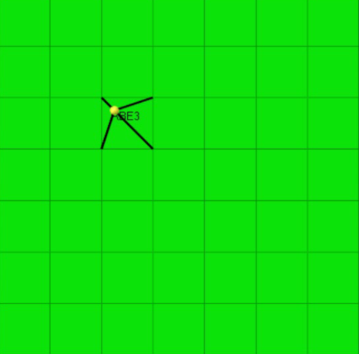

Use the Stuck Node Creation tool to create (double) RBE3 connection to "stick" nodes on QUAD or TRIA elements to make the node displacements following the element ones.
You can setup the ID for RBE3 generation upfront.
  1. From the menu bar, click Aerospace > Connections > Stuck Node.
  2. Make your selections.
  3. Click OK.
    Figure 1. . Double RBE3 creation: The same node ID is used for the dependent and the last independent node.
