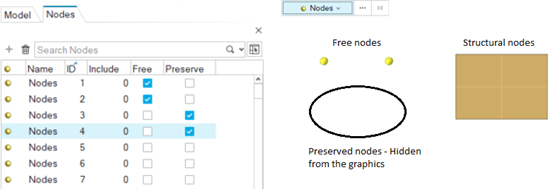

A node is displayed a small circle or sphere, depending on the mesh graphics mode. Its color is always yellow.

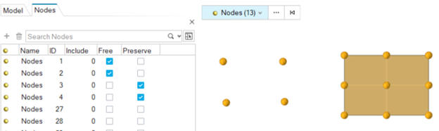

Note: Preserve nodes are a special case where these free nodes are guaranteed to be saved in the model as well as be hidden from the graphics. These can only be viewed in the Nodes Browser.
These preserved nodes can be selected from the idle node selector using the Ctrl + A keyboard shortcut.

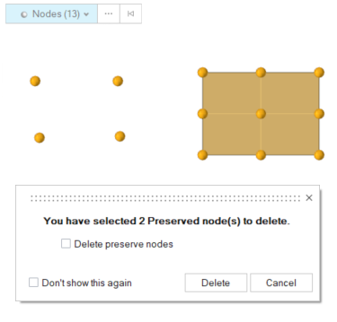

You can delete these nodes once selected, as shown in Figure 3. You will be warned of the existence of preserve nodes and, based on your selection, they will be excluded or included from the delete operation.
Figure 3.
