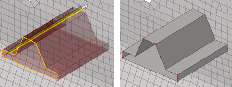

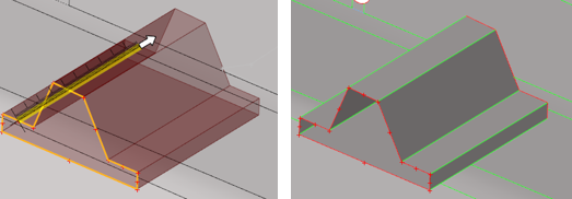

Auto-Trim
Use the auto-trim option in the microdialog when extruding nodes and lines.

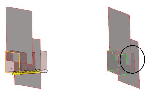

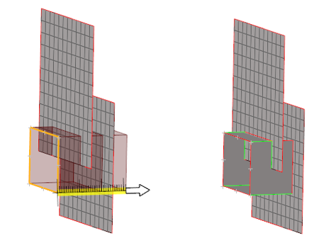

While extruding lines or nodes, if a continuous surface or mesh is intersected and this option is ON, the newly created surfaces are trimmed at the intersection. The auto-trim option works for both geometry intersecting geometry and mesh. It also works for FE topology intersecting FE topology.
Figure 2. Surfaces Intersecting with Surfaces
Figure 3. Surfaces Intersecting with Mesh

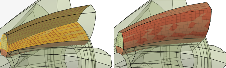

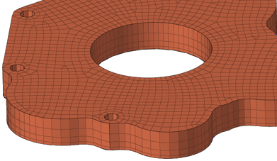

Hex Meshing
Use the Extrude tool to create a mesh of solid elements.
While the Solid Map tool can automatically create 3D mesh directly on solids as long as the solids you select are already mappable, hex meshing depends on an existing 2D mesh, which is then extrapolated into a 3D mesh based on the parameters you input.

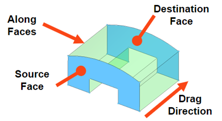

Figure 9.
  • Two opposing faces are called "Source" and "Target" faces.
  • One or more faces that directly connect and enclose the volume between the source and target are called "Guide" faces.
  • The drag direction is the vector from the source face to the destination face.

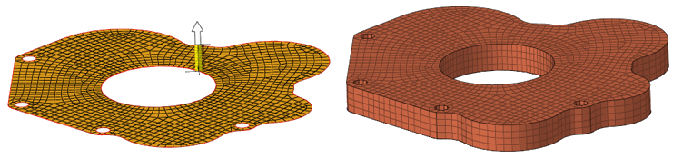

  5. Create hex mesh in one of the following ways:
    OptionDescription
    Along vector
    1. In the microdialog, set a density value or an element size if not already defined in the options menu.
    2. Enter a thickness value or drag the manipulator to create hex mesh along the element normal.

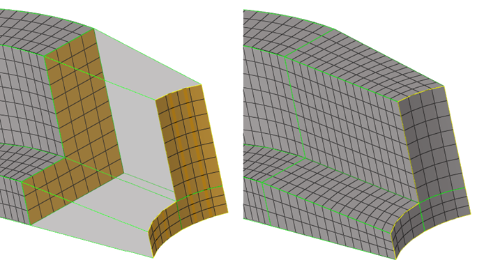

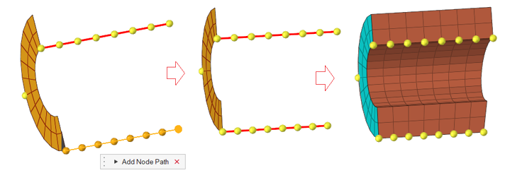

    With Guides/Targets (Optional)
    1. Click the Guides selector.
    2. Select the geometry that defines the face of the 3D volume along which you wish to map the mesh.
      When elements are used, the mapped mesh maintains the nodal positions with selected elements. They can be equivalenced to have common nodes. While selecting nodes, each selection should represent an edge that connects the source and destination.
    3. Click the Target selector.
    4. If desired, select geometry that you wish the 3D mesh to match up with.
      Figure 17.
    5. In the microdialog, set a density value or an element size if not already defined in the options menu.
    Figure 18. . Mesh created with source elements and a midline as a guide.
    Figure 19. . Mesh created with source elements and surfaces/lines as guides.
    Figure 20. . Mesh created with source elements and multiple faces and elements as guides. Topo(2D/3D) element faces are supported.
    Figure 21. . Mesh created with source elements and multiple node paths as guides.
