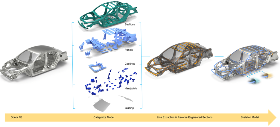

Use the Extract Line tool to generate a mid-line representation from selected input, which is essential for creating reduced-order models.
When combined with the Categorize tool, the Extract Line tool can be used to streamline the reduced-order model-building process, as shown in Figure 1.

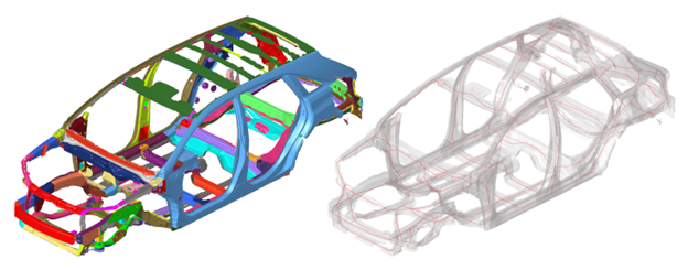

In this example, the input is the skeleton set generated by the Categorize tool. During processing, any holes in the input will be patched. Line Extract can be applied to detailed models, as demonstrated in Figure 2.
