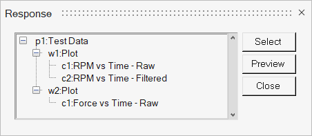

  3. Click the curve selection icon in the Response Field for Data Curves:.
  4. Choose the Force vs Time - Raw curve.
    Figure 4.

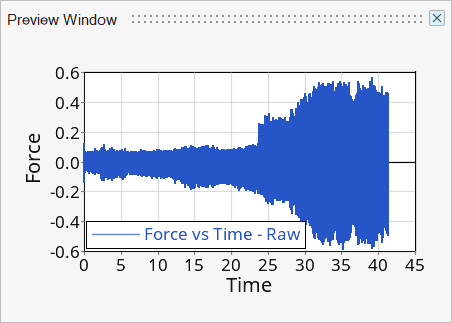

  5. Click Preview to view the curve.
    Figure 5.

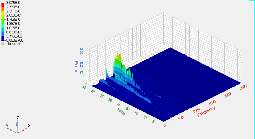

  8. Enter 100 for Number under Waterfall slices.
  9. Check the Contour waterfall option.
  10. Click Apply.
    Figure 6.

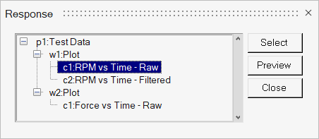

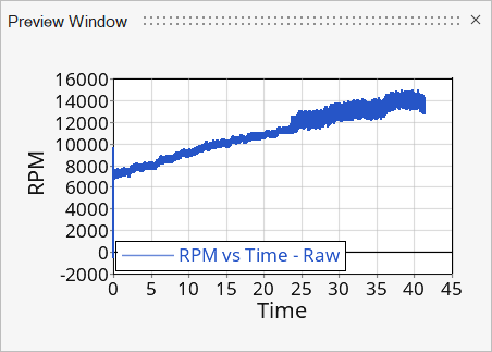

  2. Under Data Curves, select RPM vs Time – Raw for Response.
    Figure 7.
    Figure 8.

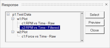

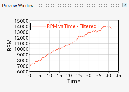

  3. Select RPM vs Time – Filtered for Input under Data Curves.
    Figure 9.
    Figure 10.

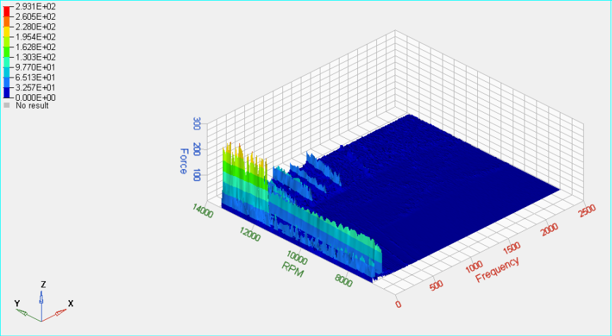

  4. Check the box for Input vector is in RPM to scale the RPM to RPS.
  5. Click Apply.
    Figure 11.

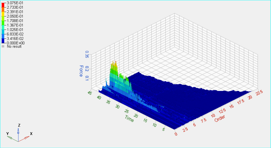

  1. For Plot Type: select Order(scaled) instead of Frequency from the pull down menu.
  2. Select RPM vs Time – Filtered for Input under Data Curves.
  3. Click Apply to create the plot.
    Figure 12.
