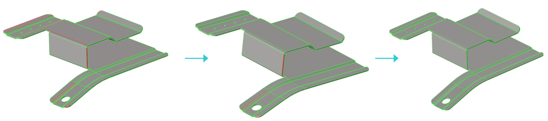

From the View Controls toolbar, click
and select
Topology.
and select
From the Topology ribbon, click
the Stitch tool.

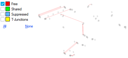

From the visualization legend, clear all check boxes except the Free check box
to display only the free edges.
These are locations that have missing surfaces.
Select the T-Junctions check box.
There are no yellow edges (there are no duplicate surfaces or T-connection).
Figure 3.
- Select All check boxes.
and select
In the modeling window, rotate, zoom, and pan to locate
any errors in the geometry.
Areas to be worked on (highlighted with red edges):
- A surface that overhangs a round corner
- Missing surfaces

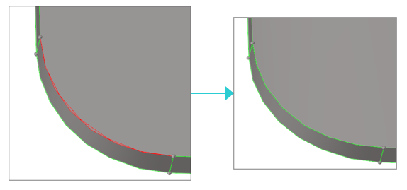

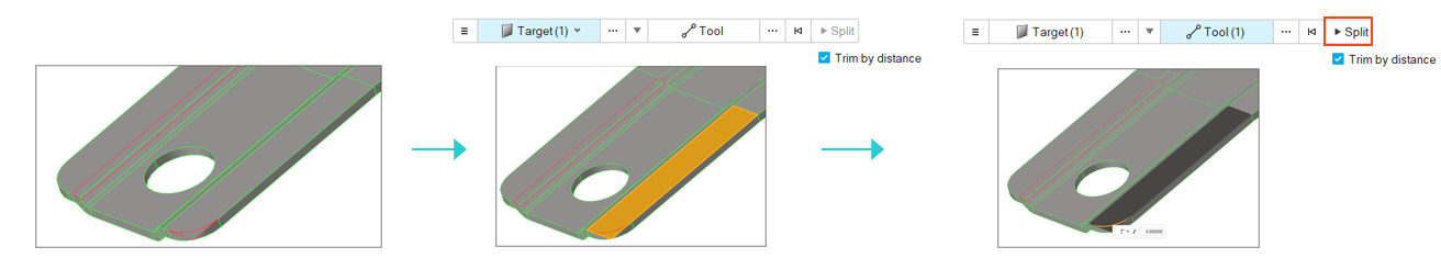

Delete Overhanging Surface
In this step, you will delete the surface that overhangs the round corner using the Split tool.
From the Topology ribbon, select
the tool.
Figure 4.

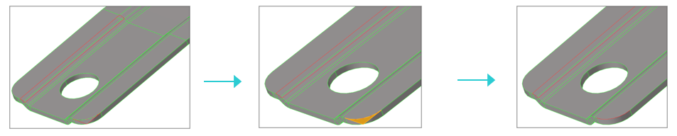

For Target and Tool, select the entities highlighted in Figure 5 and click Split.
Figure 5.

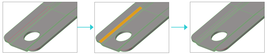

- Exit the tool.
- Set the Entity Selector to Surfaces.
In the modeling window, right-click the surface
highlighted in Figure 6 and select Delete from the context menu.
Figure 6.

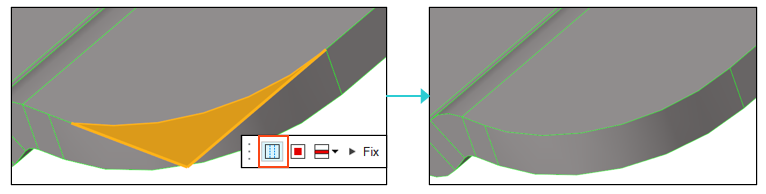

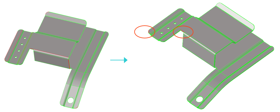

Create Surfaces
In this step, you will create surfaces to fill gaps in the model using the Patch tool.
From the 2D ribbon, select the tool.
Figure 7.
- From the guide bar, verify Patch is selected.
Select the surface edges loop highlighted in Figure 8 and confirm.
Figure 8.
- Click on the created surface to toggle tangency.

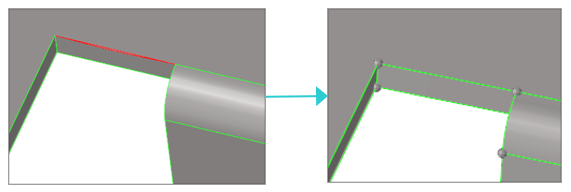

Patch the part highlighted in Figure 9 by clicking-and-dragging one edge over the other.
Note: Alternatively, you can use again Stitch tool.
Figure 9.

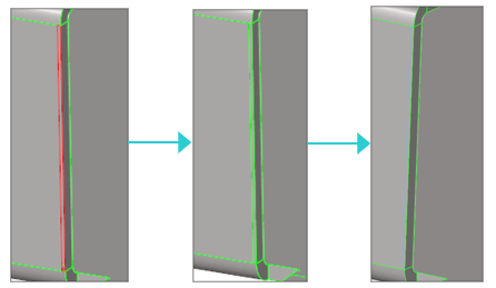

Combine Free Edges
In this step, you will combine free edges using the Stitch tool and change tolerance.
the Stitch tool.
Figure 11.
From the guide bar, click
The Options dialog opens. - Set the Maximum stitching distance to 0.01.
In the modeling window, select all surfaces displayed
and click Stitch from the guide bar.
Now only two free edges remain because the gap is larger than the stitching distance.
Figure 12.
Click-and-drag an edge to the other edge to stitch it.
Figure 13.
Repeat step 5 on the other site to correct the gap.
Figure 14.
- Review the model.

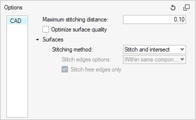

The Options dialog opens. - Set the Maximum stitching distance to 0.1.
For Stitching method, select Stitch and intersect.
Figure 16.
Figure 17.

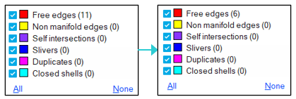

- In the modeling window, select all of the Surfaces displayed and click Find from the guide bar.
to fix identified problems
based on options.
The number of free edges decreased from 11 to six.Figure 19.
- From the visualization legend, click Free edges to review and fix edges.

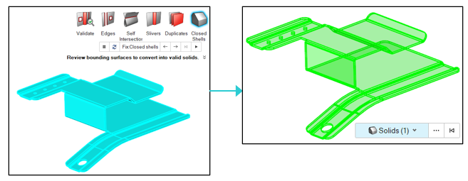

From the secondary ribbon, select the Closed shells
tool.
Figure 21.
to generate the solid
geometry.
