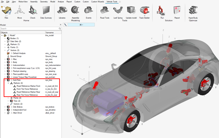

Road reference marker is the coordinate system that is used by MotionSolve to evaluate the position and orientation of the road. The road file will be evaluated with respect to the road reference marker which is also included in the Tire entities selectors.
Figure 1. Road reference markers used to orient the tire

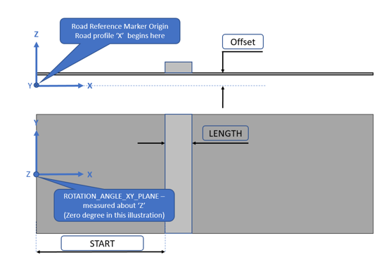

The Cleat Road is represented by a flat road with a single cleat (cuboid obstacle) that can be oriented in perpendicular or oblique direction related to the X-axis of the Road Reference Marker.
Figure 2. Cleat Road Oriented by the Road Reference Marker
In the road property file, Offset is the distance of the ground with respect to the Z-axis of the Road Reference Marker. Length measures the width of the cleat along X-axis. Rotation angle XY plane is the positive X-axis of the road with respect to the inertial frame. Start indicates the distance along the X-axis of the road from the origin to the start of the cleat.

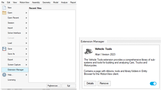

  2. Click File > Extension Manager and use the slider to load the Vehicle Tools Extension.
    Figure 3.

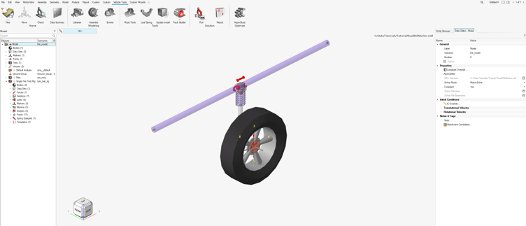

    The model is displayed in MotionView.
    Figure 5.
    Note that the Road Reference marker is located at the contact patch of the tire.
    Figure 6.

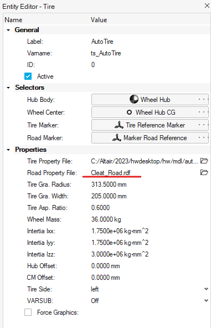

  4. Using the Entity Editor, load the Cleat_PlankRoad.rdf file as the Road property file.
    Figure 7.

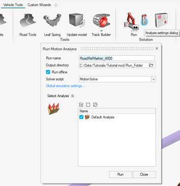

  2. Under Vehicle Tools, click on the Analysis settings dialog icon (located on the right side of the Run icon) within the Run ribbon, to open the Run Motion Analysis window.
    Figure 8.
  3. Browse and locate the required file path to save and run the current model. Specify RoadRefMarker_4000 as the Run name.
  4. Select the Run offline option and click the Run button.

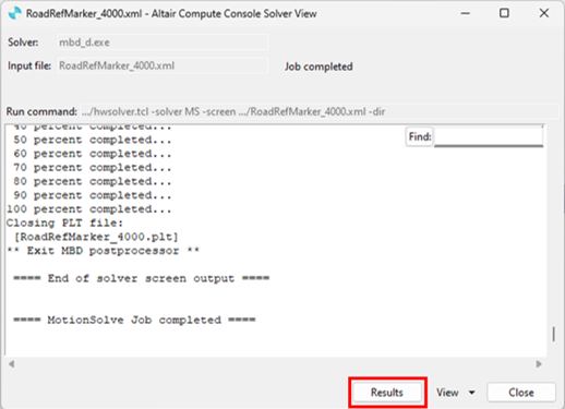

    MotionSolve is invoked in the background and runs the simulation.
  5. After the MotionSolve run is complete, click on Results.
    A new window with HyperView will open and the animation of the model can be visualized.

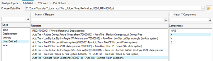

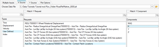

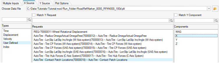

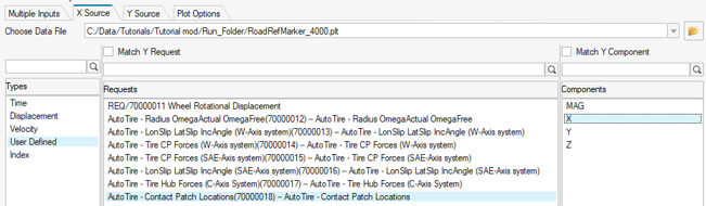

  8. Define the X-axis by clicking on X Source and selecting the following options.
    Figure 12.
    X Type User Defined
    X Request AutoTire - Contact Patch Locations(70000018) -- AutoTire - Contact Patch Locations
    X Component X

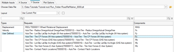

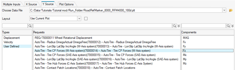

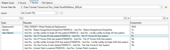

  9. Define the Y-axis by clicking on Y Source and selecting the following options.
    Figure 13.
    Y Type User Defined
    Y Request AutoTire - Tire CP Forces (W-Axis system)(70000014) -- AutoTire - Tire CP Forces (W-Axis system)
    Y Component Fz

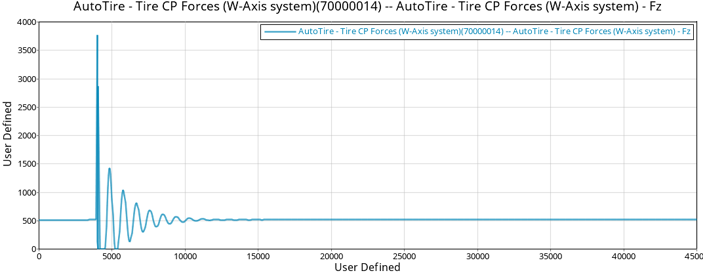

  10. Click the Plot button to obtain the following plot.
    Figure 14.
    The plot displays the Tire force (Z-axis) vs Contact patch location. The curve indicates the oscillation starting at 4000mm along the X-axis, meaning the tire reaches the obstacle at 4000mm.

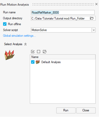

  2. In MotionView, open the Run Motion Analysis dialog and specify RoadRefMarker_8000 as the Run name.
  3. Click the Run button to initialize the simulation.

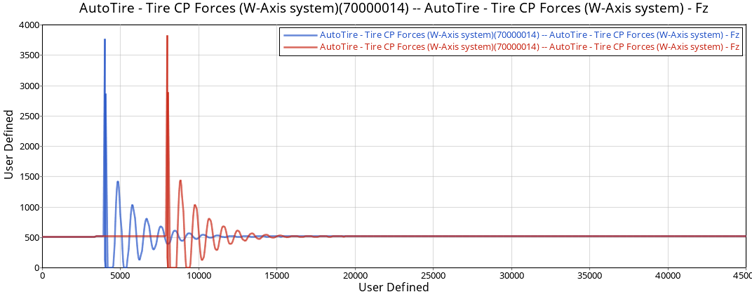

  6. Click the Plot button to visualize the two plots overlayed.
    Figure 18.
    The plot shows the modifications on Start parameter in the Road Property File. The blue curve indicates the obstacle at 4000mm along the X-axis, while the red curve shows the obstacle at 8000mm.

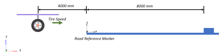

Change the Road Reference Marker Position and Verify the Results
In this step, the Road Reference Marker will be positioned 4000mm along X keeping the Road Property File with a Start parameter of 8000mm.

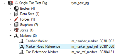

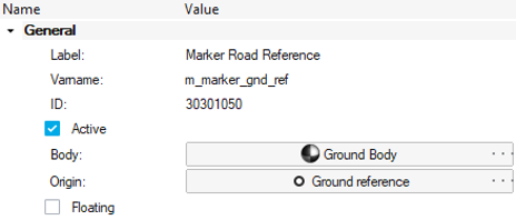

  1. In MotionView, select the Marker Road Reference in the Model Browser and check the parameters using the Entity Editor.
    Figure 19.

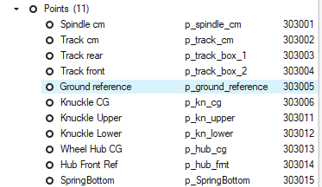

    The Road Reference Marker's origin uses the Ground reference point.
    Figure 20.
  2. Select the Ground reference point from the Model Browser and change the X coordinate value to 4000 using theEntity Editor.
    Figure 21.

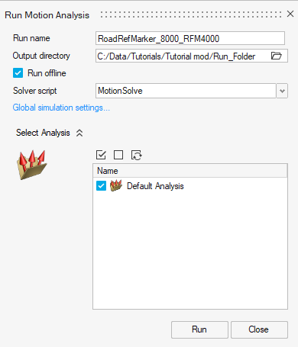

  3. From the Run Ribbon, open the Run Motion Analysis window, specify RoadRefMarker_8000_RFM400 as the Run name, and click on the Run.

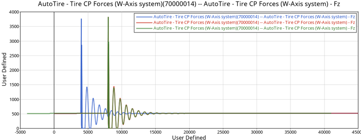

  6. Click the Plot button to visualize the three plots overlayed.
    Figure 25.
    The green curve shows the results of modifying the Road Reference Marker 4000mm keeping the start at 8000mm. You may notice that plot indicates the obstacles at 8000mm as in Step 3, but the starting point is not 0mm as before but -4000mm in X. The explanation for this is shown in the image below. The Road Reference Marker works as the reference for the road, since the marker was moved, the contact patch is now behind the reference, hence starting at a negative value.
    Figure 26.

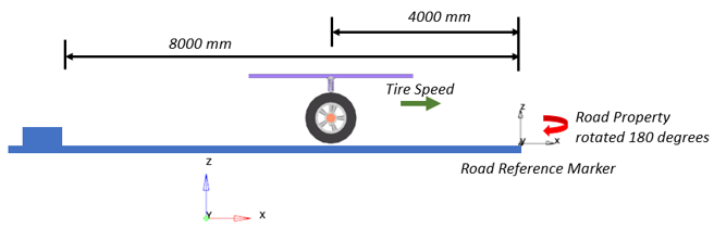

Change the Rotation Angle XY Plane to 180 and Verify the Results
In this step, the Road Property File will be rotated 180 degrees using Rotation Angle. Keep the Road Property File Start parameter at 8000 mm and the Road Reference Marker positioned at 4000 mm along X.

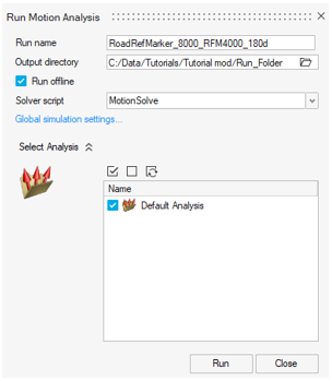

  2. In MotionView, open the Run Motion Analysis dialog and specify RoadRefMarker_8000_RFM4000_180d as the Run name. Click the Run button to simulate the model.

  4. Repeat the X and Y-axis selections.
    Figure 28.
    X Type User Defined
    X Component X

    Y Type User Defined
    Y Component Fz

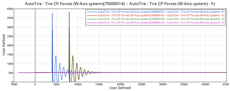

  5. Click the Plot button to visualize the four plot overlayed.
    Figure 30.
    The pink curve shows the results of rotating the Road Property File 180 degrees. It can be observed that there are no oscillations and the tire does not reach the obstacle. The explanation for this is shown in the image below. When rotating the road, the cleat moves behind the tire and opposite to the tire direction.
