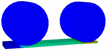

This analysis shows a phase of a rail rolling. A metal strip is successively passed through two rollers aiming at reducing its thickness. Both rollers have a constant angular velocity of 6.85 rad/s, and the metal strip is dragged along a moving machine bed. This process may be considered quasi-static and involves high deformation (mainly compression).

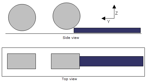

Geometry
The metal strip has a cross-section of 80 x 20 mm and the rollers have a radius of 100 mm. After the passage of the first roller, the thickness is reduced by 7 mm, then by another 5 mm after the second roller.
Figure 2. Geometry of the Problem
fig_24-1

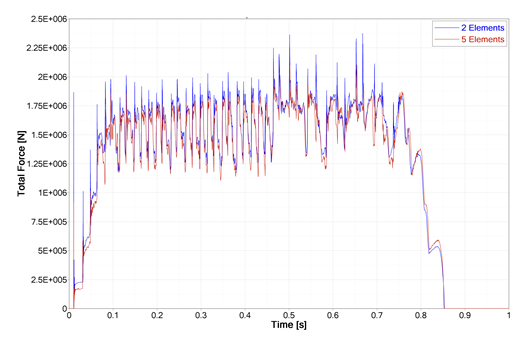

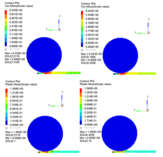

Number of Elements over the Thickness
It was mentioned earlier that passing five elements over the thickness is a minimum; but how was that number reached? It is not an easy question, as this number depends on what is being looked for. If interested in the stress distribution over the thickness, the higher the better; thus the choice would be a trade-off between accuracy and the CPU time. Compare the von Mises stress and the plastic strain for two elements over the thickness using one integration point (Isolid =1) and five elements with 8 integration points Isolid =17).
Figure 3. Comparison Between Two and Five Elements
ex_24_table_1a
Passing two elements over the thickness is not enough to see the stress (or strain) distribution; five elements is enough though. If the deformed shape is not smooth and/or the gradient between the two elements is too high, consider refining the mesh; however, this can be somewhat costly! Additionally, it takes 12 times longer to run the model with five elements over the width.
What if the only interest is in the reaction force acting on the cylinder?
Figure 4. Reaction Forces Acting on the Cylinder
ex24_fig2
The above graph indicates the reaction force on the first cylinder using two or five elements over the thickness. Both curves are almost identical and it takes much longer to use five elements. Thus, to save CPU time, there is no need to use more than two elements.

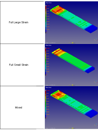

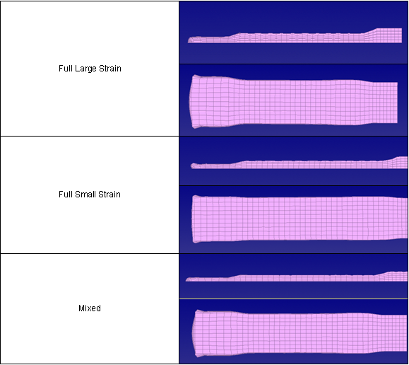

Small Strain Formulation Influence
Usually for problems involving large deformations, a large strain formulation would be used. In Radioss this is the default setting, but it is also possible to use a small strain formulation. This formulation is not very accurate for large deformations, but it is more robust and enables the time step to not decrease too much. Indeed, large deformation/rotation problems may lead to mesh distortion which causes the time step to drop drastically; computation may even stop due to a negative volume. The small strain formulation overcomes all this by assuming a constant volume, consequently the time step becomes constant, and even if the mesh is completely distorted, computation will not be stopped due to the negative volume.
This formulation can be applied from t=0 by setting the flag Ismstr to 1, directly in the type of a specific part. It is also possible to switch from a large strain formulation to a small strain formulation during the simulation in order to prevent a negative volume and/or to maintain a decent time step using the /DT/BRICK/CST option in the Engine file (*_0001.rad) having a critical time step.
In this example the results between a full large strain formulation, a full small strain formulation and a "mixed formulation" using /DT/BRICK/CST are compared. The average time step is 20% higher for a full small strain formulation and 3.5% higher for a "mixed formulation" in comparison to the default large strain formulation. Thus, there is a significant gain in terms of CPU time using the small strain formulation. The deformed shape is not good (Figure 5).
Figure 5. Deformed Shape
ex_24_table_2
Moreover, looking at the plastic strain, using a small strain formulation from t=0 leads to major errors (Figure 6). First of all, the strain distribution is not well determined and most importantly, the maximum is far too low, which means permanent deformation was under-estimated.
Figure 6. Deformed Shape

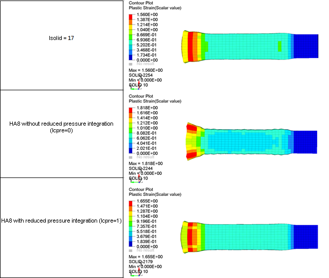

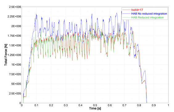

HA8 Formulation Influence
The improved solid formulation HA8 overcomes the drawbacks of the standard 8 integration points' formulation (Isolid=17 or 14). In particular, in the case of a pure bend, "shear-locking", which makes the standard formulation rather stiffer, does not exist. It is also possible to use the small strain formulation, which contrary to the 8 integration points' formulation is not compatible. It is now possible to use up to 9 integration points for each direction.
Depending on the value given for the Icpre flag, the HA8 formulation may use a reduced pressure integration. In this part the influence of this flag on simulation will be investigated in order to find out the most suitable value. Figure 8 shows both the deformed shape and the equivalent plastic strain for the different solid formulations. The new HA8 formulation with reduced pressure integration behaves the same way as the standard 8 integration points formulation. If the reduced pressure integration is not activated, the results will not be correct, with the metal strip deforming badly and the plastic strain being over-estimated (Figure 8). The reaction force acting on the cylinder will also be over-estimated (Figure 6), which means that the structure will be stiffer without the reduced pressure integration.
Figure 7. Rolling Force for Different Formulations
fig_24-3
Figure 8. Plastic Strain for Different Formulations
ex_24_table_4
The HA8 formulation must always be used with reduced pressure integration, the only time when this option must be deactivated is in the case of emulating a thick shell formulation with 8-nodes bricks.

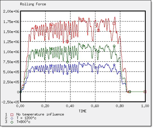

When metal forming, one of the main parameters engineers' study whether the force is needed during the process. In this particular case, it concerns the rolling force applied by the cylinders. Engineers try to minimize this force in order to use less power and to reduce maintenance on the cylinders. One way to do so is to form metal at a higher temperature. Radioss takes into account the temperature dependency using the same law already used (Johnson-Cook law). Figure 9 indicates the rolling force in accordance with the temperature and, as expected the higher the temperature, the lower the force. Consequently, metal forming is a trade-off between the power saved using a lower force and the power required to raise the temperature.
Figure 9. Rolling Force
