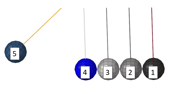

Five pendulums in line, initially in contact with each other, are struck by a sixth one. The shock wave and oscillating motion are observed.

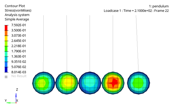

A TYPE24 contact interface uses a penalty method with a linear contact stiffness to model the contact between the balls. A self-contact definition between all the balls is used to model the contact between the nodes and the element surface. Interfaces using the penalty method are based on main/secondary treatment.
Brick elements are used to model the balls. No contact gap is required for the TYPE24 interface.

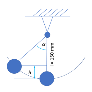

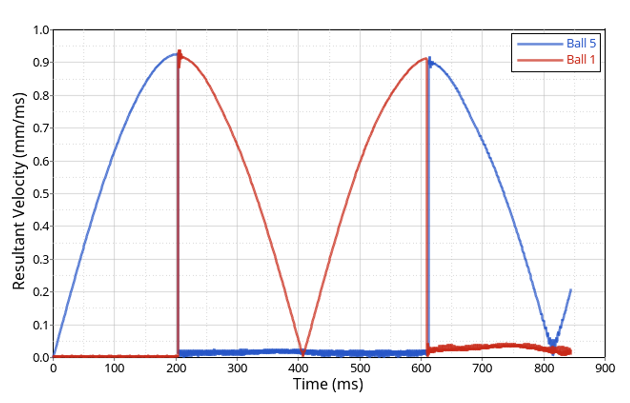

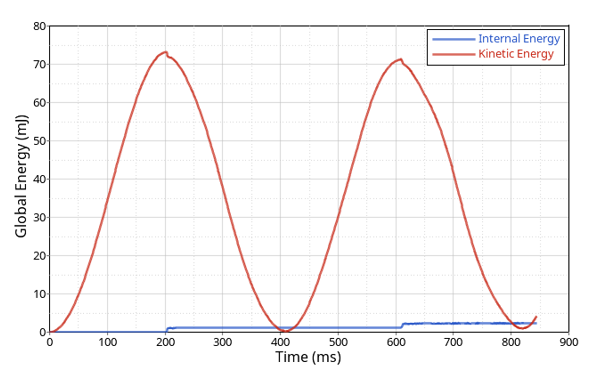

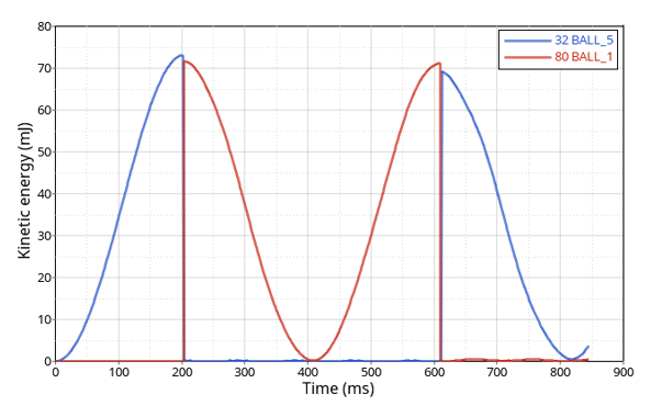

When considering the kinetic energy variation of the model, the system behaves as a simple pendulum (Figure 3).
When the pendulum mass is released at time t=0, Ball 5 (end ball) has maximum potential energy and zero kinetic energy. Ball 5 achieves maximum velocity before striking the four other pendulums. For a moderate case that is without loss, you have:
- Vertical displacement of the ball’s center
- Velocity
- Mass
