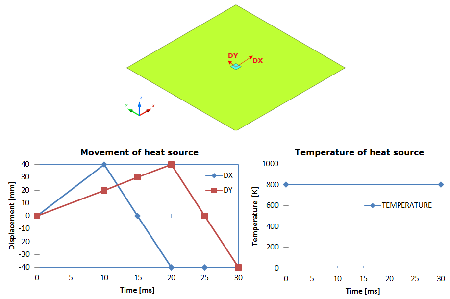

A heat source with a constant temperature of 800K is moved under imposed displacement on one plate with an initial temperature of 298K. The dimension of the heat source is 5mm x 5mm and the plate is 100mm x 100mm.
Figure 2. Problem Description
ex_53_heat_source
Units: mm, ms, g, N, and MPa

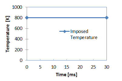

With /IMPTEMP, imposed temperature will be set on a group of nodes. The source constant temperature is defined for heat source.
Figure 3. Imposed Temperature for Heat Source
ex_53_imposed_temp

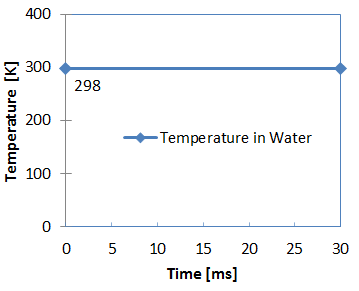

The surrounding atmosphere is water with a constant temperature of 298K, which is described in function, fct_IDT (Figure 4).
Figure 4. Water Temperature
ex_53_water_temp
Where, H is the heat transfer coefficient between structural component and its surrounding infinite room with unit [ J s ⋅ m 2 ⋅ K ] . In general, the convective heat transfer coefficient for water (free convection) is about 20 - 100 [ J s ⋅ m 2 ⋅ K ] and water (forced convection) is about 50 - 10000 [ J s ⋅ m 2 ⋅ K ] . Forced convection in water is H = 500 [ J s ⋅ m 2 ⋅ K ] = 5 e − 4 [ N ⋅ mm s ⋅ mm 2 ⋅ K ] .

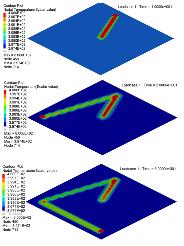

Figure 5 shows nodal temperature at time 10[ms], 20[ms] and 30[ms]. Part of heat transferred to plate through contact. Therefore, the temperature under the trace increased. The temperature on the plate decreased during the time, due to the convection with water.
Figure 5. Nodal Temperature in Plate at time=10[ms], 20[ms] and 30[ms]
ex_53_nodal_temp

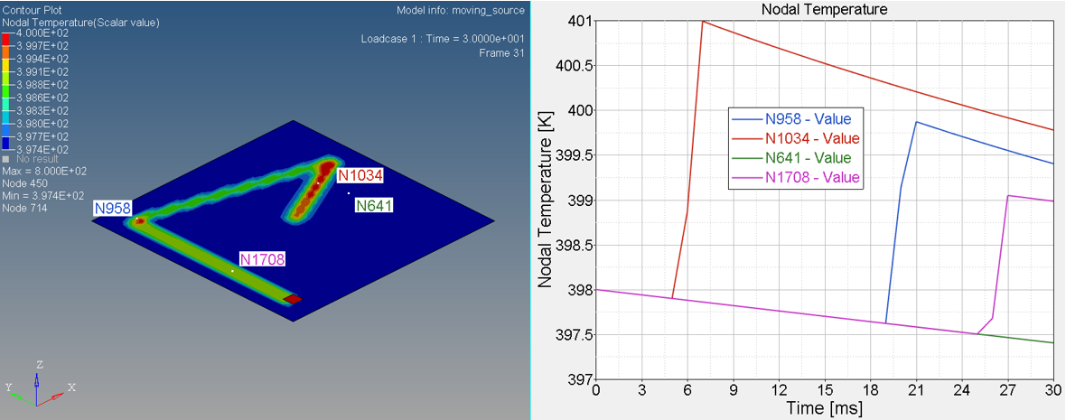

The nodal temperature on Nodal N641, N1034, N958 and N1708 are illustrated in Figure 6.
  1. Nodal N641 is not under trace. The temperature changed, only due to convection with water.
  2. Nodal N1034, N958 and N1708 are under trace. At first the temperature decreased before the heat source began, due to convection with water, and then increased, due to the heat exchange from the heat source through contact. Once the heat source is removed, the temperature decreased again, due to the heat conduction inside the material and convection with water. So the slope of the temperature decrease is much larger than N641 (only convection).
    Figure 6. Temperature on Nodal N641, N1034, N958 and N1708
