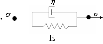

Another simple schematic model for viscoelastic materials is given by Kelvin-Voigt solid. The
model is represented by a simple spring-dashpot system working in parallel as shown in Figure 2.Figure 2. Kelvin-Voigt Model
The mathematical relation of Kelvin-Voigt solid is written as:
When (no dashpot), the system is a linearly elastic system. When =0 (no spring), the material behavior is expressed by Newton's
equation for viscous fluids. In the above relation, a one-dimensional model is considered. For
multiaxial situations, the equations can be generalized and rewritten in tensor form.

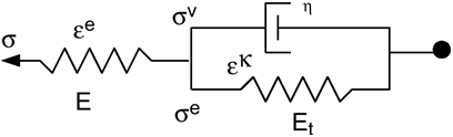

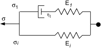

The Maxwell and Kelvin-Voigt models are appropriate for ideal stress relaxation and creep
behaviors. They are not adequate for most of physical materials. A generalization of these laws
can be obtained by adding other springs to the initial models as shown in Figure 3 and Figure 4. The equations related to the generalized Maxwell model are
given as:
The mathematical relations which hold the generalized Kelvin-Voigt model are:
The combination of these equations enables to obtain the expression of stress and strain
rates:
Figure 3. Generalized Maxwell Model Figure 4. Generalized Kelvin-Voigt Model
