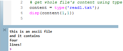

Read all content of an ASCII file.
You can use the type function to display the content of the specified file. You do not need to open and close the file, as shown in the example below:
content = type('read1.txt'); disp(content{1,1})You may find read1.txt under <install/tutorials/.
Run this script in the Editor or OML Command window.
This is a simple way to check the content of the ASCII file.

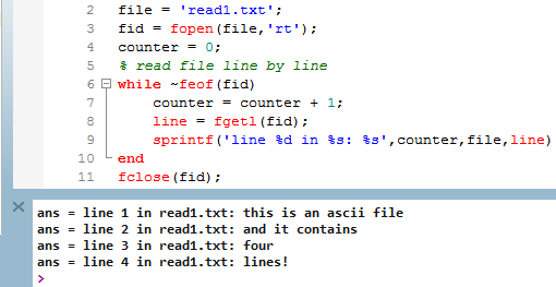

Read the ASCII file line by line.
When the file is large and contains multiple lines, and the application requires you to manipulate specific lines or strings, it may be more efficient to read the file line by line:
file = 'read1.txt'; fid = fopen(file,'rt'); counter = 0; % read file line by line while ~feof(fid) counter = counter + 1; line = fgetl(fid); sprintf('line %d in %s: %s',counter,file,line) end fclose(fid);This returns:
If you want to read data from a file, you must first open it. This is done by using fopen('/Path/to/File') in the Editor window:
fid = fopen('read1.txt','rt');This assigns a file ID to the variable fid that can be referenced later on. The second input of fopen is the option to be used. In this case, use rt for read, which means the file is read in text mode. fgetl(fid) function returns the whole line content in the file fid. feof(fid) is used to decide if fid has encountered the end of the file.

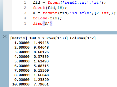

Read an ASCII file with formatted fields using fscanf.
Sometimes data with the ASCII format is saved in a specific format. The function fscanf can handle this case. First, a file must be created:
fid = fopen('read2.txt','wt'); fprintf(fid,'%4s %8s\n','node','displacement'); for i = 1:100 fprintf(fid,'%4d %8s\n',i,num2str(rand*10)); end fclose(fid);Open read2.txt, created in OML, and you’ll notice the format looks like this:
Try to read this file using fscanf:
fid = fopen('read2.txt','rt'); fseek(fid,18); A = fscanf(fid,'%d %f\n',[2 inf]); fclose(fid); disp(A')Run this script in the Editor window; the results are printed in the OML Command window:
Note that the result saved in matrix
A'is the same as the one just saved in read2.txt. To breakdown this script:fseek(fid,18) is used to update the file pointer so as to jump the first line in read2.txt.
fscanf(fid,’%d %f\n’,[2 inf]) matches a matrix with two rows and as many columns as possible using the format
‘%d %f\n’. -

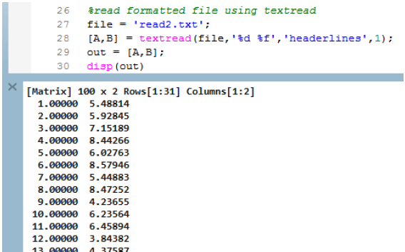

Read an ASCII file with formatted fields using the textread
function.
You can also use textread to fulfill the same job as fscanf, as shown in the example below:
file = 'read2.txt'; [A,B] = textread(file,'%d %f','headerlines',1); out = [A,B]; disp(out)This results in:
The second input argument of textread() specifies the format, while the third and fourth input arguments lead you to skip the first line of read2.txt (one header line).
