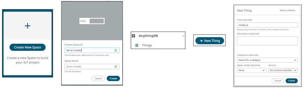

General Setup on IoT Studio-IoT Platform
In IoT Studio, .

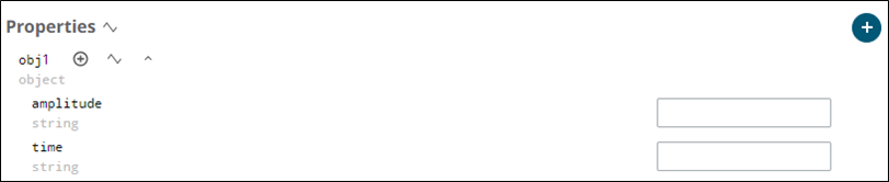

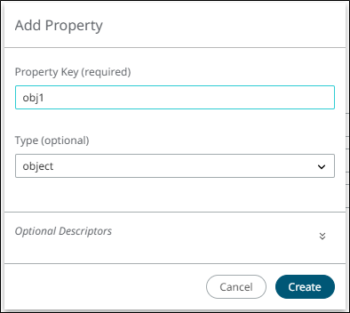

After the Thing is created, a property is created to receive data from Compose and be stored on IoT Studio.
Select .

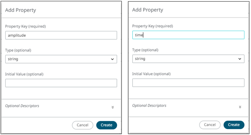

Create Properties to be attributed to this object:

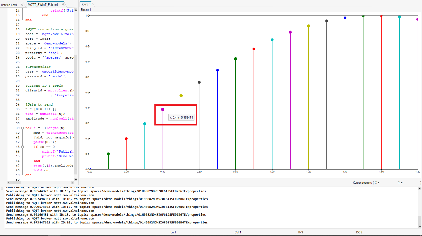

Create a loop to send the sinusoidal data individually. IoT Studio requires JavaScript Object Notation (JSON)
format on the data. For that, a function is used to manipulate the data
individually, accessing each cell member of the sinusoidal wave. Finally, a plot
is created, having 0.5 seconds as a pause condition, to see what is the data
that is sent:

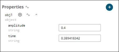

for i = 1:length(t) msg = jsonencode(struct(property, struct('amplitude', num2str(time{i}), 'time', num2str(amplitude{i})))); [mid, rc, msginfo] = mqttpublish(clientid, topic, msg, 2, true); pause(0.5); if rc == 0 printf('Publishing to MQTT broker %s\n', host) printf('Send message %s with ID:%s, to topic: %s\n',num2str(amplitude{i}),num2str(mid), topic) end stem(t(i),amplitude{i}); hold on; endIt is possible to see that the data sent from Compose is being received on IoT Studio using the MQTT protocol.

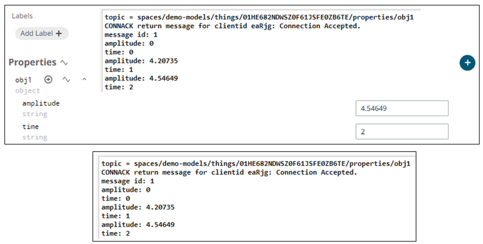

[mid1, rc1, msginfo1] = mqttsubscribe(clientid, topic, 0);Considering that Compose is subscribed to the topic, if any message is sent from one device to that topic, Compose receives it:
It is possible to see that the data sent from IoT Studio is being received on Compose using the MQTT protocol.
