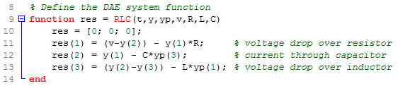

Unlike ordinary differential equations, differential algebraic systems must be rearranged in terms of residuals:

The system function looks like this, using y in the code for the vector [i, VR, VL].

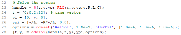

- Pass the circuit variables to the DAE system function using a handle.
- Define the times at which to solve the system.
- Define the initial values of [i, VR, VL] in
y. - Define the initial values of the [i, VR, VL]
derivatives in
yp. - Set tolerances. The defaults are explicitly specified below for illustration.
- Call
ode15iwith the inputs.
The code looks like this:

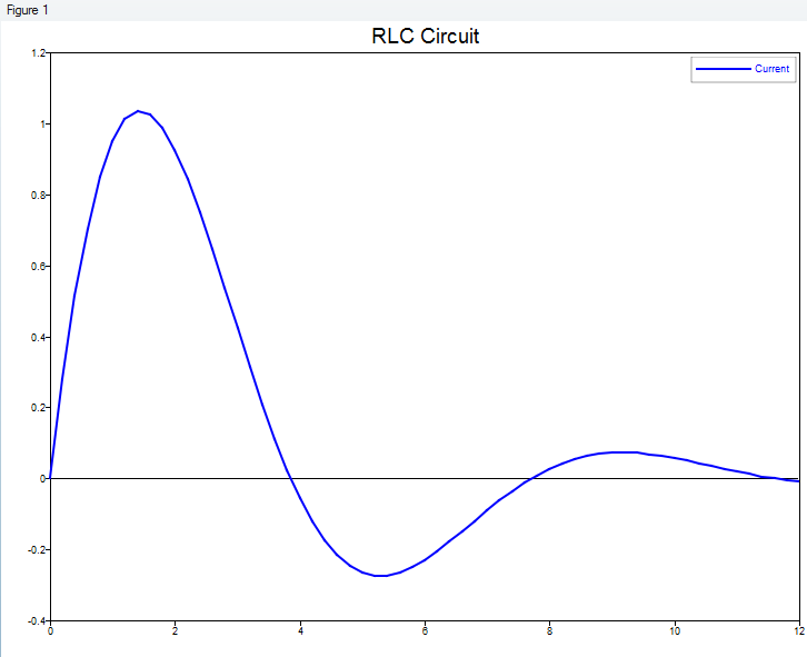

The time vector is reproduced as the first output argument. It is identical to the input for this case. The second output argument, v, contains the values of i, VR, VL by column at each time in vector t.
The following code extracts and plots the results.
