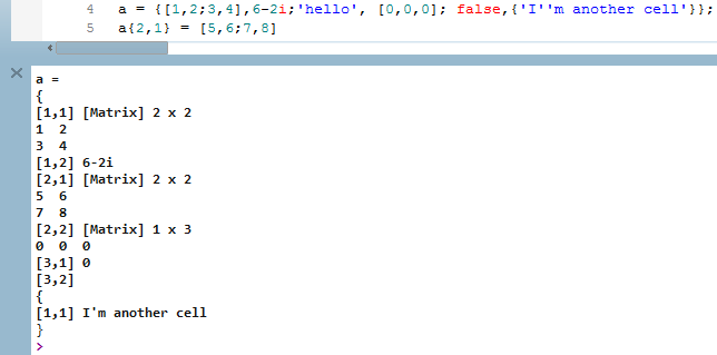

Modifying an Element in a Cell
If you want to modify an element in an already-created cell, you can reference the element and reassign just that particular one.
  1. To reference a particular element in a cell, use a{x,y} with a being the name of the cell and x and y being the row and column, respectively. If you want to modify the element in a{2,1} add the following:
    a{2,1} = [5,6;7,8]
  2. Click Run to see the following results:
    In this case, we see that the element at [2,1] was changed from the string 'hello' to the matrix [5,6;7,8].

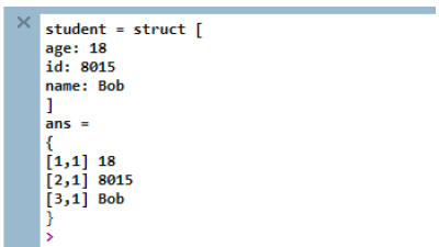

Convert a Struct to a Cell
Structs can be easily transferred to a cell by calling the build-in function struct2cell. The original struct’s fields change to the number index, as shown below:
student.name = 'Bob';
student.age = 18;
student.id = 8015
% transfer a struct to a cell
struct2cell(student)
This returns:

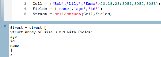

Convert a Cell to Struct
You can convert a cell to a struct by using cell2struct. Since a struct must contain field names, you need to determine the field names before converting. See the example below:
Cell = {'Bob','Lily','Emma';20,18,25;8051,8052,8053};
Fields = {'name','age','id'};
Struct = cell2struct(Cell,Fields)
This script converts a cell to a struct with the fields name, age, and id respectively:

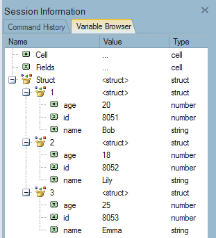

Click + in front of Struct in the Variable Browser to expand this struct. The Variable Browser displays this:
