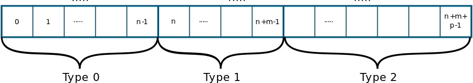

Particle data in the array is organized in order of particle type. Particle type data is structured in order of particle index. However, particle indices may change between simulation time steps and therefore the index cannot be relied upon as a method for persistent particle tracking. Instead, persistent tracking can be accomplished through the unique integer identifier (ID) found in each particle data set, which persists throughout the entirety of the simulation. If you want to perform operations on all of the particles of one type, independently of the particle ID, then it is more efficient to do so by accessing the array of particle data by index.
The data of each type is organized such that particle data is accessible using the index.
In this case, particles of Type 0 occupy array indices 0 to (n-1), while Type 1
particles occupy the indices n to (n+m-1) and finally particles of Type 2 occupy indices
(n+m) to (n+m+p-1). The number of particle types and particles belonging to each type
