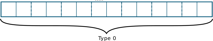

When custom property data is returned from EDEM, it is returned in an order that matches the particle data as described in the Retrieving Particle Data from EDEM section.
Custom properties with more than one element have the elements stored sequentially, in the same manner as the force and torque arrays. Therefore, a two element property for a single particle type simulation would be structured as follows.
