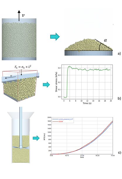

Models that capture the poured bulk density, static angle of repose described in Standard Test Method for Bulk Solids Characterization by Carr Indices, ASTM International, West Conshohocken, PA, 2021, steady state shear stress measured in direct shear described in Standard Test Method for Shear Testing of Bulk Solids Using the Jenike Shear Tester, ASTM International, West Conshohocken, PA, 2016 and the works of R. Freeman FT4 Basic Flowability Energy (BFE) described in Measuring the flow properties of consolidated, conditioned and aerated powders - A comparative study using a powder rheometer and a rotational shear cell, Powder Technol. 174 (2007) 25–33 are included in the database.

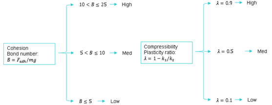

- The bulk cohesion and compressibility, which are qualitatively categorized using
the bond number and the EEPA contact plasticity ratio respectively.
