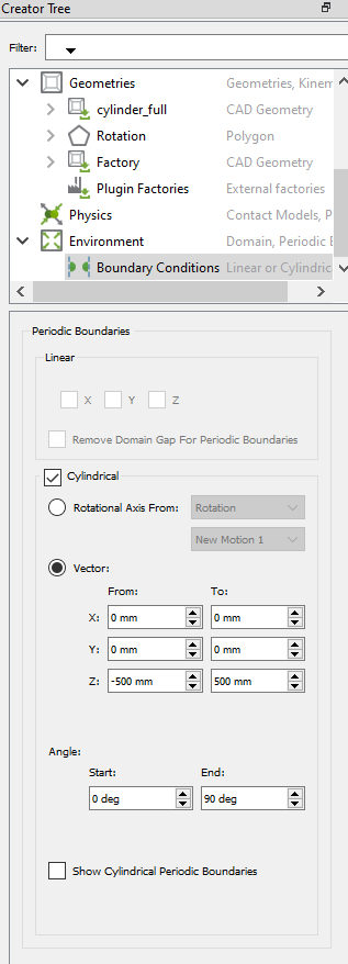

In the Creator Tree, expand the Environment menu and then select
Boundary Conditions.
- Select the Cylindrical checkbox to enable the cylindrical boundary condition.
- Specify the Start Angle and End Angle of the boundary as appropriate for the simulation.

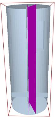

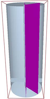

Select the Show Cylindrical Periodic Boundaries checkbox
to visualize the boundary conditions in the Viewer.
In the following example, the mixer has four blades at 90 degrees separation. In this case, the angle should be set to 90 degrees.
