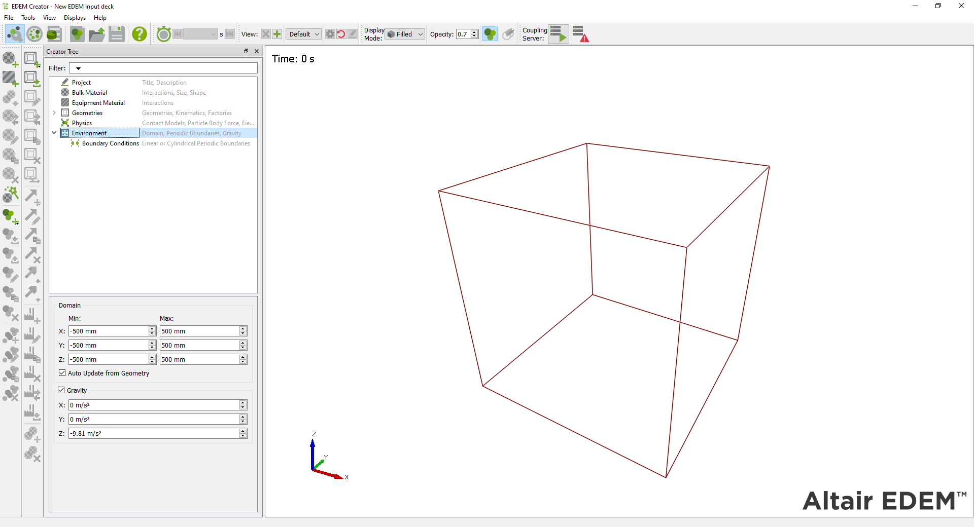

EDEM allows you to run simulations in the model domain area. You define the domain and Geometry in the Environment section of the Creator Tree and is indicated by the red box in the Viewer.
Select Environment in the Creator Tree.
Specify the minimum and maximum values for the
X,Y, and
Z to define the extents of the domain. This is
represented by the red box in the Viewer.
Domain size has an effect on simulation time - the larger the domain, the longer the simulation will take to run. Particles that move out of the domain during the course of the simulation are permanently removed from the simulation (unless you have selected a periodic boundary condition). Geometries can move in and out of the domain during a simulation.
Select the Auto update from Geometry checkbox to
automatically fit the domain around any sections of the defined Geometry to
create the smallest domain possible.
