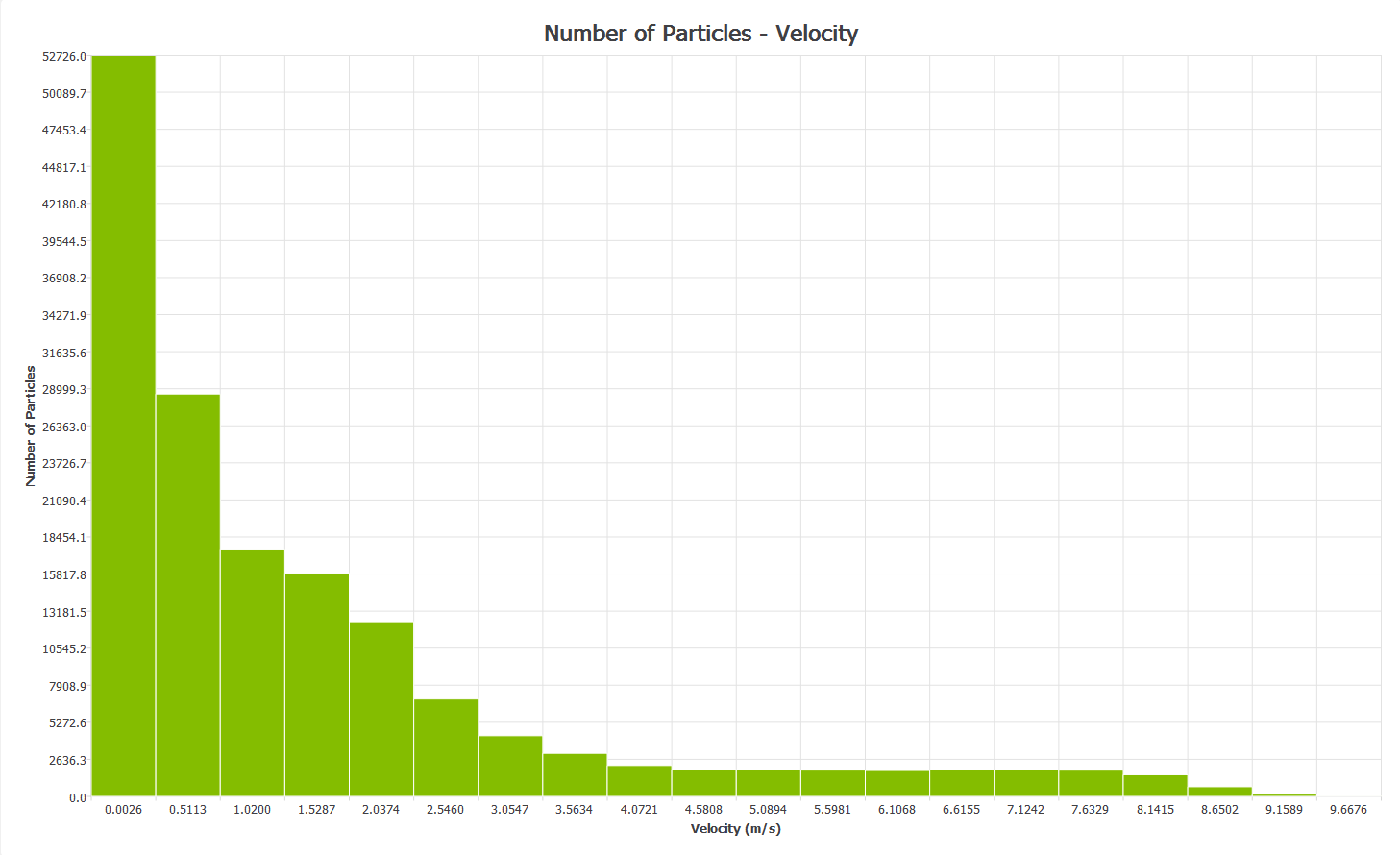

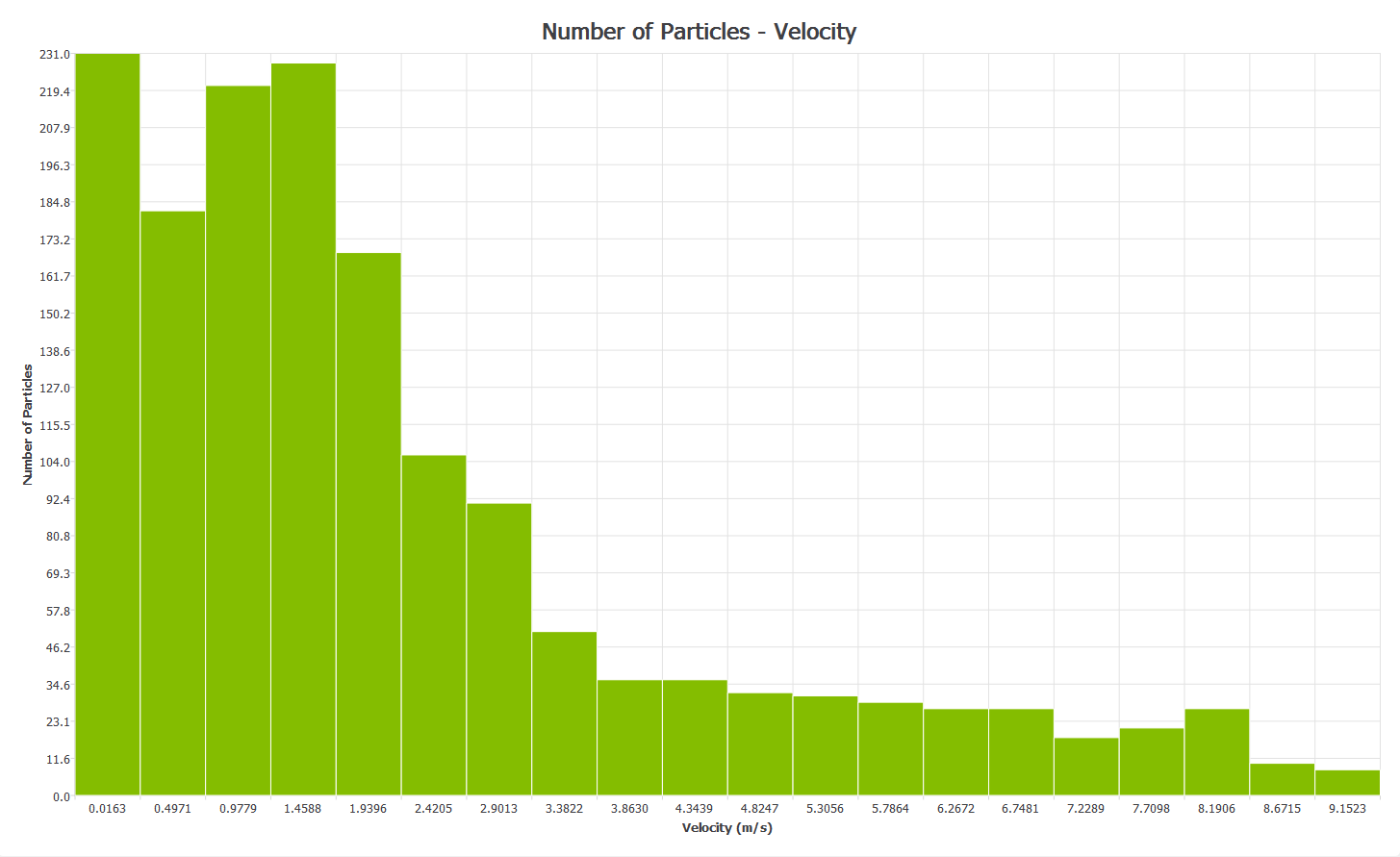

By default, the Current Time Step is selected. For example, the following Histograms show the distribution of particles traveling in particular velocity ranges - one Time Step, so each particle is only counted once, and the second for a range of 100 Time Steps.

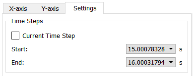

Clear the Current Time Step checkbox to set a
different Start and End time.
Grayed-out Time Steps indicate partial saves and may not contain all the data you want to plot. -
