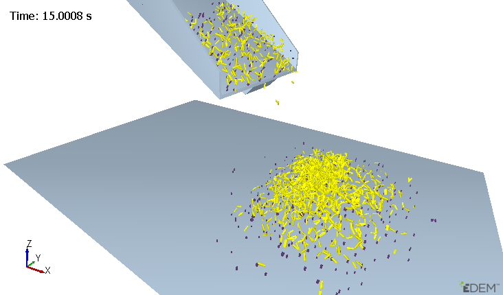

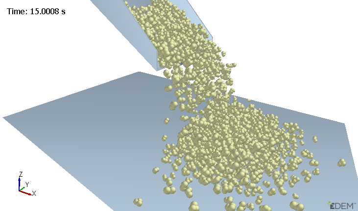

For Specify Display Contact Select the checkbox to display contacts in the Viewer. Note: Selecting the checkbox may result in slow graphics performance.The following image shows an example of standard particles displayed:

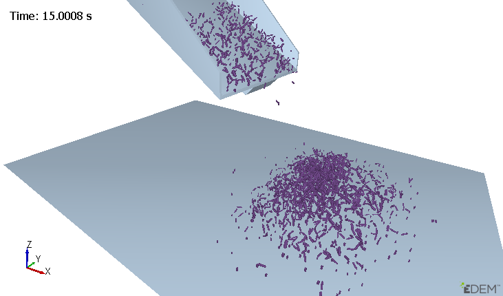

The following image shows an example where particles are not displayed and contacts are displayed:

Opacity Changes the opacity of the contact display. Coloring Color By Indicates the color by which the contacts or contact groups will be visualized. Options are:- UniformThe contact group or groups will be visualized by the defined color. The following example shows Particle-particle contacts colored yellow and particle-geometry contacts colored purple:
