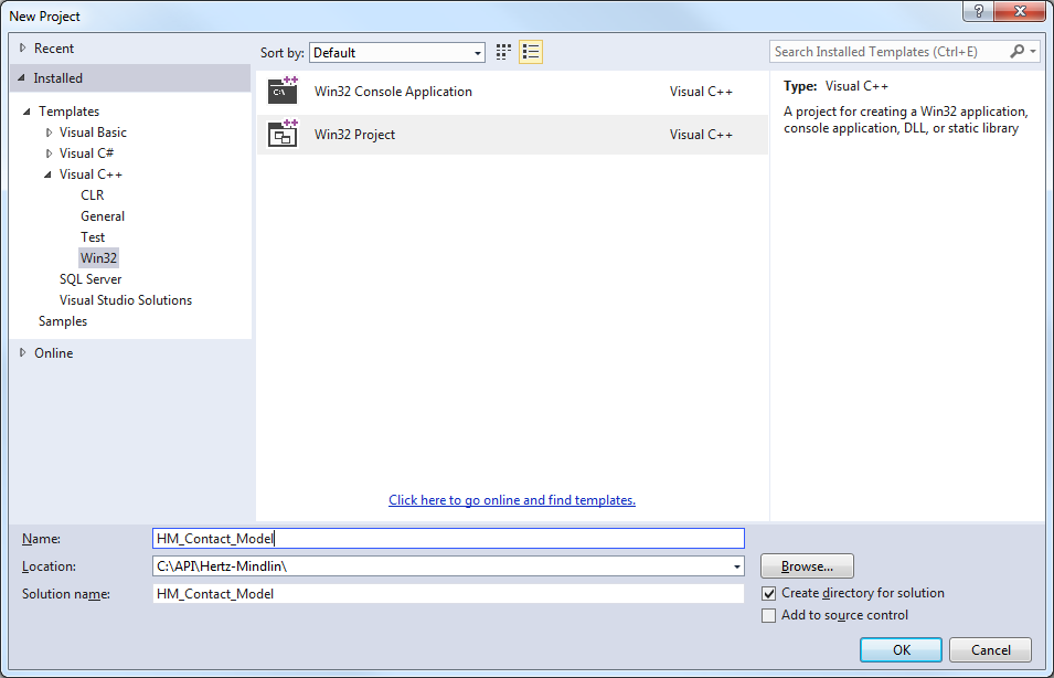

- Create a new Project.
- Open Visual C++ For Windows Desktop and go to .
- Select Win32 Console Application.
- Specify a project name and location and click OK.

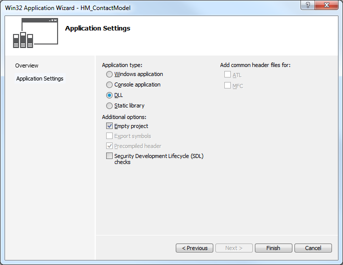

- On the next window, go to Application Settings and select DLL in the Application Type dropdown list.
- Select Empty Project and then click
Finish.

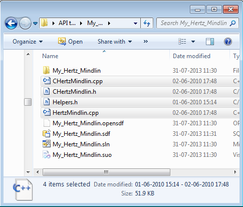

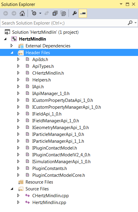

- Copy your written
.cppand.hfiles to the newly created project folder.Note: EDEM header files are also required before the model for compilation. The additional header files are available at the following location: . - Copy the following files from Core and Contact Models to your Project
folder:
IPluginContactModel.hIPluginContactModelV3_3_0.hPluginContactModelCore.hApiIds.hApiTypes.hIApi.hIApiManager_1_0.hICustomPropertyDataApi_1_0.hICustomPropertyManagerApi_1_0.hPluginConstants.h
- Right-click Header files and Source
files to add the file to the Visual Studio Project.

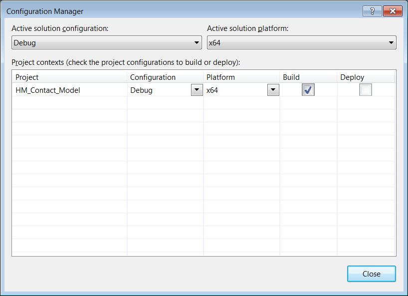

The Configuration Manager dialog box is displayed. - Select Release or Debug
and build the solution from .
A
.dllfile which can be loaded into EDEM is created.

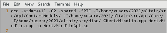

Create a Compilation Script
- Use a text editor such as Emacs, Vim or Gedit, and create a new text file
similar to the previous command (edited for your particular filenames and
included directories) and save it with a file name of your choice such
as
compileScript, in the same folder as your source code.
In this case, Vim is used, which should be available to all Linux distributions, though the text editors available to you might mean it is easier to use something else.

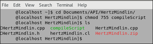

- Navigate to the directory where you have saved your script using the
cdcommand, and then make the script an executable using the commandchmod 755 compileScript.

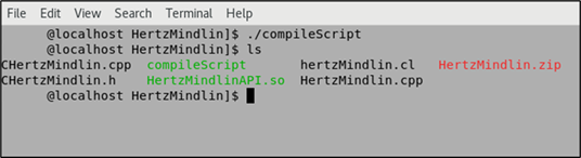

When you list the contents of the directory using the
lscommand, thecompileScripthas executable permissions (which now shows in green). - Run the compile script using
./compileScriptand your.sofile is created.
- When compiling another model, you must change the included directories and file names in this script, or modify the script to accept arguments instead.
