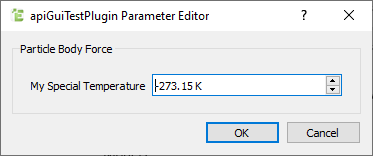

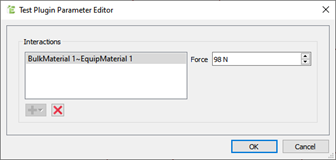

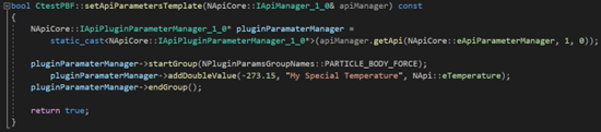

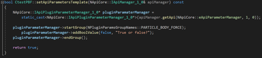

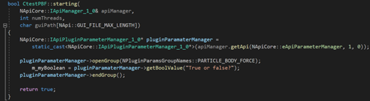

- In the apiGuiTestPlugin Parameter Editor dialog box, add
a custom particle temperature as a Body Force.

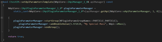

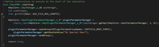

- Add a custom mass for all Particle-Particle contacts.

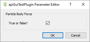

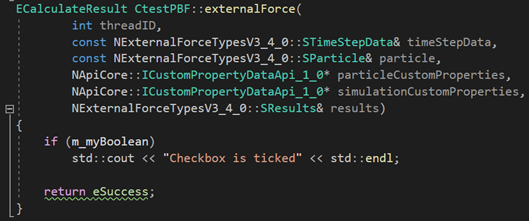

- Add a custom checkbox for enabling the output of a print statement using a Body
Force.

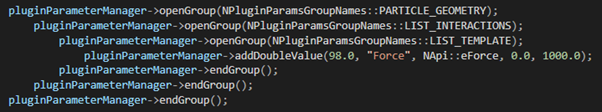

- Add a custom force for Particle-Geometry contacts, defined as a Material Interaction.
- Open the Particle-Geometry group, and then open the materials Interactions Group.
- Within that group, define a parameter called 'force':
In this example, the minimum (0.0) and maximum (1000.0) values are defined.

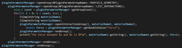

- Define a force for each material pair.

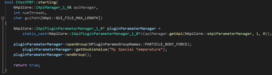

- To access force values in the code, iterate over all material pairs.

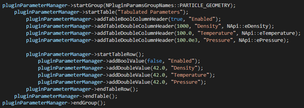

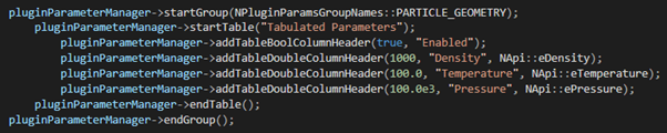

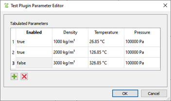

- To define parameters in a table (a table is similar to a group, except that
values are defined in columns):
You can add as many rows as desired.

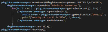

- Access the parameters by iterating over rows as follows:
- Define a set of default rows. Note: In this case, you can still edit the values of those rows but you cannot remove the rows. Therefore, a minimum number of rows is enforced.
The row is now editable, but the icon is disabled.
