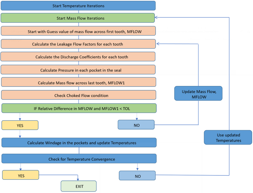

The Labyrinth Seal Tooth by Tooth (TbT) element is typically used to model leakage flow through labyrinth seals found in rotating machinery (gas turbines). The flow rate, swirl, and fluid temperature rise, due to windage, are calculated based on the seal geometry and fluid conditions at the inlet and exit of the seal.
This element's main feature is that it performs a tooth by tooth marching along the flow direction to calculate the pressure distribution inside the seal. It also takes into account local (in-pocket) changes in fluid properties due to changes in pressure and temperature, thus providing a more detailed modeling of the labyrinth seals.
The seal clearance is the main dimension that controls the flow rate passing through the seal. It is the distance between the tip of the seal tooth and the opposite surface, which is usually honeycomb. The seal clearance changes during gas turbine operations since the parts move due to temperature and rotation. With the labyrinth seal TbT element, you can input individual seal clearances for every tooth in the seal and study their impact on leakage.
The element is typically used for compressible flow, but Flow Simulatoralso uses this element with incompressible or compressible fluid.

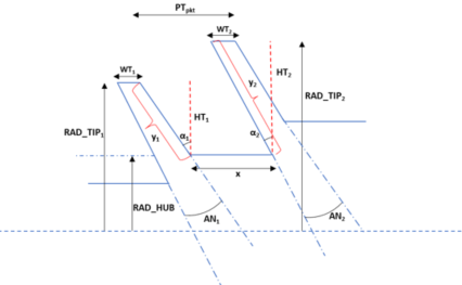

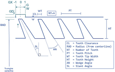

The figure below shows the geometric inputs. The seal clearance and seal geometry are the major inputs. Besides this, you must enter honeycomb information.

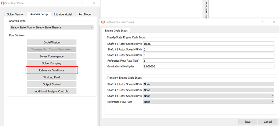

A labyrinth seal typically has the seal teeth rotating. This requires you to enter an RPM reference condition in the Solution Panel.
Figure 3.
Labyrinth TbT Seal Inputs
The inputs for the labyrinth TbT seal are listed below. See the image in the user interface to understand the geometric variables.
Labyrinth Seal TbT Element Input Variables
Index UIName (*.flo label) Description
1 Seal Clearance (CL) Seal clearance.
This can be averaged or tooth by tooth).
2 Nominal Seal Radius or Inlet Radius (RAD) Nominal seal radius for a straight seal or the inlet radius for a stepped seal.
It can be a constant for the entire seal or vary tooth by tooth.
The constant value provided is assigned to every tooth in the seal.
Tooth by tooth radius values can be provided in a table. The application writes the flag "-999" to the *.flo file if table entries exist. Every pocket is identified as either straight or stepped based on the individual tooth radius.
3 Number of Teeth (NT) Number of teeth in the seal.
4 Seal Axial Pitch (PT) Seal axial pitch.
It can be a constant for the entire seal or vary pocket by pocket.
Pocket by pocket pitch values can be provided in a table. The application writes the flag "-999" to the *.flo file if table entries are present.
5 Tooth Tip Width (WT) Axial width of seal tooth tip.
Tooth by tooth width values can be provided in a table. The application writes the flag "-999" to the *.flo file if table entries exist.
6 Seal Tooth Height (HT) Seal tooth height.
This variable influence only the windage calculated for a rotating seal.
Tooth by tooth height values can be provided in a table. The application writes the flag "-999" to the *.flo file if table entries exist.
7 Wedge Angle (AN) Angle between sides of a seal tooth.
Tooth by tooth wedge angle values can be provided in a table. The application writes the flag "-999" to *.flo file if table entries exist.
8 Rotor Surf. Rot. Speed (RPMSELR) Rotational speed pointer of seal rotor surface.
0.0: Specifies a stationary element.
1.0: Points to general data ELERPM(1).
2.0: Points to general data ELERPM(2).
3.0: Points to general data ELERPM(3).

9 Slant Angle (SL) Angle the tooth centerline makes with the radial direction.
Positive angle if tooth is angled into the flow and negative angle if slanted away from the flow.
Tooth by tooth slant angle values can be provided in a table. The application writes the flag "-999" to the *.flo file if table entries exist.
10 Land Surf. Rot. Speed (RPMSELL) Rotational speed pointer of seal land surface. 0.0: Specifies a stationary element.

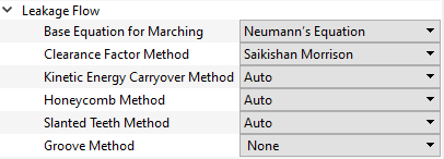

11 BASE_EQUATION BASE EQUATION is the user dependent choice for pressure calculation formula in tooth by tooth marching:
0: Saikishan-Morrison Base Equation.
1: Neumann Base Equation.
2: Compressible Flow Function.
The details of these base equations are provided in the Theory Section.

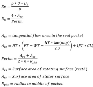

14 Laminar-Transitional Reynolds Number (RE_LAM) Reynolds number below which pocket swirl flow is assumed to be laminar. Flow at Reynolds numbers between RE_LAM and RE_TURB are assumed to be in the transition region. Defaults to 2070 for Labyrinth Seal.
15 Turbulent-Transitional Reynolds Number (RE_TURB) Reynolds number above which pocket swirl flow is assumed to be turbulent. Flow at Reynolds numbers between RE_LAM and RE_TURB are assumed to be in the transition region. Defaults to 2530 for Labyrinth Seal.

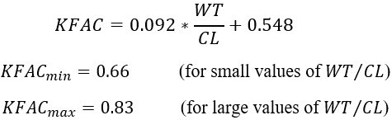

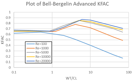

16 Clearance Factor Method (KFAC_METHOD) 0: Bell-Bergelin curve for CD of annular orifice.
1: Bell-Bergelin Advanced, Table Lookup for multiple Re (Default).
-1: User supplies their own KFAC, either constant value or calculated using controllers. See KFAC details below.
17 Kinetic Energy Carryover Method (KE_METHOD) 0: Vermes 1961 Kinetic Energy Carryover curve.
1: Morrison Kinetic Energy Carryover curve.
2: Minimum of Vermes and Morrison curves (default, matches NASA Tipton data best).
3: Saikishan-Morrison.
4: Neumann Kinetic Energy Carryover curve.
5: Stepped Kinetic Energy Carryover.
6: Auto.
-1: User-supplied KEMULT, either constant value or calculated using controllers. See KEMULT details below.

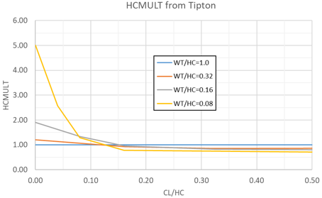

18 Honeycomb Method (HC_METHOD) 1: Auto, Tipton/Schramm Method (Default) – Tipton for Straight Seals, Schramm for Stepped Seals.
2: Stocker curve for straight seals.
3: Schramm curve for stepped seals.
4: Tipton table lookup for straight seals.
-1: User-supplied HCMULT, either constant value or calculated using controllers. See HCMULT details below.

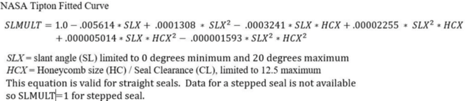

19 Slanted Teeth Method (SL_METHOD) 1:Curve fitted to NASA Tipton data.
-1:User supplies their own SLMULT, either constant value or calculated using controllers. See SLMULT details below.
2: Auto.
3: Stepped slanted tooth factor.
20 Honeycomb Size (HCSIZE) Honeycomb Size – Standard choices are 1/32”, 1/16”, and 1/8”. However, it is possible to input a custom honeycomb size. Solver units are inches.
21 Clearance Factor(KFAC) Clearance factor is the Discharge Coefficient of a single annular orifice or tooth gap. The value is between 0 and 1, usually between 0.6 and 0.9. See Vermes 1961 or Bell-Bergelin.

23 Honeycomb Flow Multiplier (HCMULT) Honeycomb Flow Knockdown Factor is a multiplier that is applied to non-honeycomb leakage flow to calculate the corrected leakage flow with a honeycomb stator. Typical values are from 0.8 to 1.2. Values less than one imply the honeycomb is supplying an additional source of resistance, which is often true for straight seals. Values greater than one imply that the honeycomb is creating a new path for leakage flow, which is often true for stepped seals. Please see Stocker and Schramm for additional details.
24 Slant Flow Multiplier (SLMULT) Slanted Teeth Flow Knockdown Factor is a multiplier that is applied to straight-tooth leakage flow to calculate the corrected leakage flow with slanted teeth. Typical values are from 0.85 to 1.1. Three-dimension flows in seal pockets are complex, and it is difficult to explain why the factor is sometimes less than one and sometimes greater.

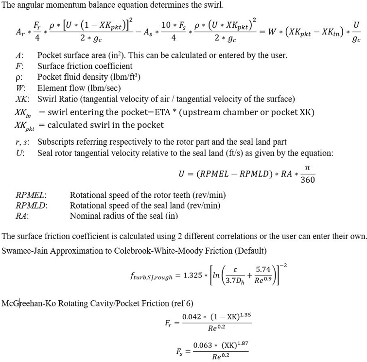

25 Swirl Carryover Factor per Tooth (ETATOOTH) Swirl Carryover per Tooth is the fraction of tangential fluid velocity(relative to the stator) that passes each tooth and enters the next pocket. This is a calibration parameter that helps to match the correct swirl and windage heating. It is especially useful for stepped honeycomb seals where the air passes over the tooth and immediately impinges on the honeycomb step.

26 Friction and Windage – Rotor:
Friction Relation (FRIC_REL_R)
0: Swamee-Jain Approximation to Colebrook-White-Moody Friction (Default).
1: MacGreehan-Ko Rotating Cavity/Pocket Friction.
5: Sultanian.
-1: User-supplied FRICF_STATOR, either constant value or calculated using controllers. See FRICF_STATOR details below.
27 Rotor Sandgrain Roughness (ROUGH_ROTOR) Roughness of the rotor surface. It is assumed to be a sand-grain type roughness, which is consistent with Colebrook-White-Moody.
28 Friction and Windage – Rotor:
Friction Multiplier (F_MULT_ROTOR)
Friction multiplier on Rotor is used if you want the friction curve to follow that same basic trend as Swamee-Jain or MacGreehan-Ko but your custom friction curve differs by a multiplication factor.
29 Friction and Windage – Rotor:
Friction Coefficient (FRICF_ROTOR)
Fanning Friction Coefficient on Rotor can be supplied as a constant value, or it can be calculated using a controller.
30 Friction and Windage – Rotor:
Total Rotor Surface Area (ASR)
Generally, ASR=0 and the rotor friction area is calculated from other geometric inputs such as tooth height, spacing, wedge angle, slant angle, etc. If you enter a non-zero value, your input overrides the calculated area. Solver units are sq. in.
31 Friction and Windage – Stator:
Friction Relation (FRIC_REL_S)
5: Sultanian.
32 Stator Sandgrain Roughness (ROUGH_STATOR) Roughness of the stator surface. It is assumed to be a sand-grain type roughness, which is consistent with Colebrook-White-Moody. Estimating a suitable roughness for a honeycomb surface is one challenge, but no advice can be given here.
33 Friction and Windage – Stator:
Friction Multiplier (F_MULT_STATOR)
Friction multiplier on Stator is used if you want the friction curve to follow that same basic trend as Swamee-Jain or MacGreehan-Ko but your custom friction curve differs by a multiplication factor.
34 Friction and Windage – Stator:
Friction Coefficient (FRICF_STATOR)
Fanning Friction Coefficient on Stator can be supplied as a constant value, or it can be calculated using a controller.
35 Friction and Windage – Stator:
Total Land Surface Area (ASS)
Generally, ASR=0 and the rotor friction area is calculated from other geometric inputs such as tooth height, spacing, wedge angle, slant angle, etc. If you enter a non-zero value, your input will override the calculated area. This is especially useful for stepped seals, since the current lab Seal element does not have a step height input. However, it could be better to ignore the step height and rely on ETATOOTH – please see above. Solver units are sq. in.

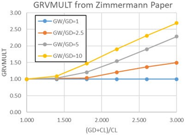

37 Groove Depth (GRV_DEPTH) Depth of the groove (GD) in the honeycomb (or other land material).
38 Groove Width (GRV_WIDTH) Width of the groove (GW) in the honeycomb (or other land material).
39 Groove Tooth Axial Position (GRV_AX) Location of the tooth in the groove. 0 = tooth in the center of the groove.
-1 = tooth hitting left edge of groove1 = tooth hitting right edge of groove.
Not used in built-in methods yet but can be useful for controller or custom groove loss correlations.
40 Groove Multiplier (GRV_MULT) Groove Flow Knockdown Factor is a multiplier that is applied to a no-groove leakage flow to calculate the leakage flow with a groove. Can be greater or less than 1. If the tooth is outside the groove, GRV_MULT should be > 1 indicating more flow through the seal.
41 Groove Method (GRV_METHOD) Method to use to calculate the groove effect.
-1= User Specified GRV_MULT 1 = Zimmerman Method.

Table 8 Individual Tooth Wedge Angle An array of the individual tooth wedge angle, one for each tooth.

KFAC
KFAC, or clearance factor, is equivalent to the Vermes K variable that accounts for the effect of the ratio of seal tooth tip width to the seal clearance. There are five options:
  • 0. Bell-Bergelin (Ref 3)
    The value used approximates the data shown in Figure 2 of the Vermes paper (also from Bell-Bergelin, ref. 3) and is given by the equation:
  • 1. Bell-Bergelin Advanced. Uses a table of KFAC vs WT/CL for several Reynolds numbers from Ref. 3. Bilinear interpolation used to find KFAC. The Bell-Bergelin equation shown above matches the Re = 10,000 curve. The Advanced option is more accurate for Re < 10,000. Re is the annular orifice (tooth gap) Reynolds number and can be found in the *.res file.
    Figure 4.

SLMULT
  1. Auto.
    The Auto method uses the recommended NASA Tipton Fitted Curve for straight teeth pockets, and the Stepped Slanted Tooth Factor for stepped teeth pockets. This is the default option.
    Note: For the first tooth of a stepped seal, there is no pocket upstream, hence the Auto method applies the recommended straight correlation for the first tooth.
  2. Stepped Slanted Tooth Factor.
    SLMULT = 1.0.
  3. User Specified.
    You can enter your own Slanted Tooth Factor. The application writes a flag (-1) when you input a Slanted Tooth Factor.

  4. Tipton Straight (Ref 7, Fig 26).
    An HCMULT is calculated using a bilinear interpolation of the curves shown here.
    Figure 5.

GVRMULT
The flow knockdown factor due to a groove in the honeycomb.
There are two options:
  • -1: User Specified
  • 1: Based on Zimmerman (Fig. 7 in Ref 8).
    Figure 6.
    The groove width/groove depth (GW/GD) is limited in the solver to between 1 and 10. The (groove depth + clearance)/clearance ((GD+CL)/CL) is limited in the solver to between 1 and 3. Valid for Re>5000, GW/GD>2.5, but correlation uses GW/GD=1 curve also.

Tooth by Tooth Marching Algorithm
Figure 7.
Calculation of Seal Pocket Swirl

Seal with Individual Tooth Characteristics
Figure 9.
Where,
R A D _ T O O T H 1 = R A D _ T I P 1 − H T 1 2   MathType@MTEF@5@5@+= feaahqart1ev3aqatCvAUfeBSjuyZL2yd9gzLbvyNv2CaerbuLwBLn hiov2DGi1BTfMBaeXatLxBI9gBaerbd9wDYLwzYbItLDharqqtubsr 4rNCHbGeaGqiVu0Je9sqqrpepC0xbbL8F4rqqrFfpeea0xe9Lq=Jc9 vqaqpepm0xbba9pwe9Q8fs0=yqaqpepae9pg0FirpepeKkFr0xfr=x fr=xb9adbaqaaeGaciGaaiaabeqaamaabaabaaGcbaaeaaaaaaaaa8 qacaWGsbGaamyqaiaadseacaGGFbGaamivaiaad+eacaWGpbGaamiv aiaadIeapaWaaSbaaSqaa8qacaaIXaaapaqabaGcpeGaeyypa0Jaam OuaiaadgeacaWGebGaai4xaiaadsfacaWGjbGaamiua8aadaWgaaWc baWdbiaaigdaa8aabeaak8qacqGHsisldaWcaaWdaeaapeGaamisai aadsfapaWaaSbaaSqaa8qacaaIXaaapaqabaaakeaapeGaaGOmaaaa paWaaSbaaSqaa8qacaGGGcaapaqabaaaaa@4CD8@
R A D _ T O O T H 2 = R A D _ T I P 2 − H T 2 2 MathType@MTEF@5@5@+= feaahqart1ev3aqatCvAUfeBSjuyZL2yd9gzLbvyNv2CaerbuLwBLn hiov2DGi1BTfMBaeXatLxBI9gBaerbd9wDYLwzYbItLDharqqtubsr 4rNCHbGeaGqiVu0Je9sqqrpepC0xbbL8F4rqqrFfpeea0xe9Lq=Jc9 vqaqpepm0xbba9pwe9Q8fs0=yqaqpepae9pg0FirpepeKkFr0xfr=x fr=xb9adbaqaaeGaciGaaiaabeqaamaabaabaaGcbaaeaaaaaaaaa8 qacaWGsbGaamyqaiaadseacaGGFbGaamivaiaad+eacaWGpbGaamiv aiaadIeapaWaaSbaaSqaa8qacaaIYaaapaqabaGcpeGaeyypa0Jaam OuaiaadgeacaWGebGaai4xaiaadsfacaWGjbGaamiua8aadaWgaaWc baWdbiaaikdaa8aabeaak8qacqGHsisldaWcaaWdaeaapeGaamisai aadsfapaWaaSbaaSqaa8qacaaIYaaapaqabaaakeaapeGaaGOmaaaa aaa@4B5D@
C L a v g =   C L _ T O O T H 1 +   C L _ T O O T H 2 2 MathType@MTEF@5@5@+= feaahqart1ev3aqatCvAUfeBSjuyZL2yd9gzLbvyNv2CaerbuLwBLn hiov2DGi1BTfMBaeXatLxBI9gBaerbd9wDYLwzYbItLDharqqtubsr 4rNCHbGeaGqiVu0Je9sqqrpepC0xbbL8F4rqqrFfpeea0xe9Lq=Jc9 vqaqpepm0xbba9pwe9Q8fs0=yqaqpepae9pg0FirpepeKkFr0xfr=x fr=xb9adbaqaaeGaciGaaiaabeqaamaabaabaaGcbaaeaaaaaaaaa8 qacaWGdbGaamita8aadaWgaaWcbaWdbiaadggacaWG2bGaam4zaaWd aeqaaOWdbiabg2da9iaacckadaWcaaWdaeaapeGaam4qaiaadYeaca GGFbGaamivaiaad+eacaWGpbGaamivaiaadIeapaWaaSbaaSqaa8qa caaIXaaapaqabaGcpeGaey4kaSIaaiiOaiaadoeacaWGmbGaai4xai aadsfacaWGpbGaam4taiaadsfacaWGibWdamaaBaaaleaapeGaaGOm aaWdaeqaaaGcbaWdbiaaikdaaaaaaa@4FAE@
Use the following to calculate the seal “rotor” surface area:
α 1 = A N 1 2 + S L 1 MathType@MTEF@5@5@+= feaahqart1ev3aqatCvAUfeBSjuyZL2yd9gzLbvyNv2CaerbuLwBLn hiov2DGi1BTfMBaeXatLxBI9gBaerbd9wDYLwzYbItLDharqqtubsr 4rNCHbGeaGqiVu0Je9sqqrpepC0xbbL8F4rqqrFfpeea0xe9Lq=Jc9 vqaqpepm0xbba9pwe9Q8fs0=yqaqpepae9pg0FirpepeKkFr0xfr=x fr=xb9adbaqaaeGaciGaaiaabeqaamaabaabaaGcbaaeaaaaaaaaa8 qacqaHXoqypaWaaSbaaSqaa8qacaaIXaaapaqabaGcpeGaeyypa0Za aSaaa8aabaWdbiaadgeacaWGobWdamaaBaaaleaapeGaaGymaaWdae qaaaGcbaWdbiaaikdaaaGaey4kaSIaam4uaiaadYeapaWaaSbaaSqa a8qacaaIXaaapaqabaaaaa@413B@
α 2 = A N 2 2 − S L 2 MathType@MTEF@5@5@+= feaahqart1ev3aqatCvAUfeBSjuyZL2yd9gzLbvyNv2CaerbuLwBLn hiov2DGi1BTfMBaeXatLxBI9gBaerbd9wDYLwzYbItLDharqqtubsr 4rNCHbGeaGqiVu0Je9sqqrpepC0xbbL8F4rqqrFfpeea0xe9Lq=Jc9 vqaqpepm0xbba9pwe9Q8fs0=yqaqpepae9pg0FirpepeKkFr0xfr=x fr=xb9adbaqaaeGaciGaaiaabeqaamaabaabaaGcbaaeaaaaaaaaa8 qacqaHXoqypaWaaSbaaSqaa8qacaaIYaaapaqabaGcpeGaeyypa0Za aSaaa8aabaWdbiaadgeacaWGobWdamaaBaaaleaapeGaaGOmaaWdae qaaaGcbaWdbiaaikdaaaGaeyOeI0Iaam4uaiaadYeapaWaaSbaaSqa a8qacaaIYaaapaqabaaaaa@4149@
y 1 = H T cos α 1 MathType@MTEF@5@5@+= feaahqart1ev3aqatCvAUfeBSjuyZL2yd9gzLbvyNv2CaerbuLwBLn hiov2DGi1BTfMBaeXatLxBI9gBaerbd9wDYLwzYbItLDharqqtubsr 4rNCHbGeaGqiVu0Je9sqqrpepC0xbbL8F4rqqrFfpeea0xe9Lq=Jc9 vqaqpepm0xbba9pwe9Q8fs0=yqaqpepae9pg0FirpepeKkFr0xfr=x fr=xb9adbaqaaeGaciGaaiaabeqaamaabaabaaGcbaaeaaaaaaaaa8 qacaWG5bWdamaaBaaaleaapeGaaGymaaWdaeqaaOWdbiabg2da9maa laaapaqaa8qacaWGibGaamivaaWdaeaapeGaae4yaiaab+gacaqGZb WaaeWaa8aabaWdbiabeg7aH9aadaWgaaWcbaWdbiaaigdaa8aabeaa aOWdbiaawIcacaGLPaaaaaaaaa@427F@
y 2 = H T cos α 2 MathType@MTEF@5@5@+= feaahqart1ev3aqatCvAUfeBSjuyZL2yd9gzLbvyNv2CaerbuLwBLn hiov2DGi1BTfMBaeXatLxBI9gBaerbd9wDYLwzYbItLDharqqtubsr 4rNCHbGeaGqiVu0Je9sqqrpepC0xbbL8F4rqqrFfpeea0xe9Lq=Jc9 vqaqpepm0xbba9pwe9Q8fs0=yqaqpepae9pg0FirpepeKkFr0xfr=x fr=xb9adbaqaaeGaciGaaiaabeqaamaabaabaaGcbaaeaaaaaaaaa8 qacaWG5bWdamaaBaaaleaapeGaaGOmaaWdaeqaaOWdbiabg2da9maa laaapaqaa8qacaWGibGaamivaaWdaeaapeGaae4yaiaab+gacaqGZb WaaeWaa8aabaWdbiabeg7aH9aadaWgaaWcbaWdbiaaikdaa8aabeaa aOWdbiaawIcacaGLPaaaaaaaaa@4281@
x = P T p k t − W T 2 − H T 1 * tan α 1 − H T 2 * tan α 2 MathType@MTEF@5@5@+= feaahqart1ev3aqatCvAUfeBSjuyZL2yd9gzLbvyNv2CaerbuLwBLn hiov2DGi1BTfMBaeXatLxBI9gBaerbd9wDYLwzYbItLDharqqtubsr 4rNCHbGeaGqiVu0Je9sqqrpepC0xbbL8F4rqqrFfpeea0xe9Lq=Jc9 vqaqpepm0xbba9pwe9Q8fs0=yqaqpepae9pg0FirpepeKkFr0xfr=x fr=xb9adbaqaaeGaciGaaiaabeqaamaabaabaaGcbaaeaaaaaaaaa8 qacaWG4bGaeyypa0JaamiuaiaadsfapaWaaSbaaSqaa8qacaWGWbGa am4Aaiaadshaa8aabeaak8qacqGHsislcaWGxbGaamiva8aadaWgaa WcbaWdbiaaikdaa8aabeaak8qacqGHsislcaWGibGaamiva8aadaWg aaWcbaWdbiaaigdaa8aabeaak8qacaGGQaGaciiDaiaacggacaGGUb WaaeWaa8aabaWdbiabeg7aH9aadaWgaaWcbaWdbiaaigdaa8aabeaa aOWdbiaawIcacaGLPaaacqGHsislcaWGibGaamiva8aadaWgaaWcba Wdbiaaikdaa8aabeaak8qacaGGQaGaaeiDaiaabggacaqGUbWaaeWa a8aabaWdbiabeg7aH9aadaWgaaWcbaWdbiaaikdaa8aabeaaaOWdbi aawIcacaGLPaaaaaa@5854@
Surface area per pocket:
Surface area for all pockets:
A r s _ t o t a l = ∑ 1 n u m   p k t A r s MathType@MTEF@5@5@+= feaahqart1ev3aqatCvAUfeBSjuyZL2yd9gzLbvyNv2CaerbuLwBLn hiov2DGi1BTfMBaeXatLxBI9gBaerbd9wDYLwzYbItLDharqqtubsr 4rNCHbGeaGqiVu0Je9sqqrpepC0xbbL8F4rqqrFfpeea0xe9Lq=Jc9 vqaqpepm0xbba9pwe9Q8fs0=yqaqpepae9pg0FirpepeKkFr0xfr=x fr=xb9adbaqaaeGaciGaaiaabeqaamaabaabaaGcbaaeaaaaaaaaa8 qacaWGbbWdamaaBaaaleaapeGaamOCaiaadohacaGGFbGaamiDaiaa d+gacaWG0bGaamyyaiaadYgaa8aabeaak8qacqGH9aqpdaGfWbqabS WdaeaapeGaaGymaaWdaeaapeGaamOBaiaadwhacaWGTbGaaiiOaiaa dchacaWGRbGaamiDaaqdpaqaa8qacqGHris5aaGccaWGbbWdamaaBa aaleaapeGaamOCaiaadohaa8aabeaaaaa@4D3F@
The labyrinth seal “stator” surface area is calculated using the following:
P s t a t _ p k t = P T MathType@MTEF@5@5@+= feaahqart1ev3aqatCvAUfeBSjuyZL2yd9gzLbvyNv2CaerbuLwBLn hiov2DGi1BTfMBaeXatLxBI9gBaerbd9wDYLwzYbItLDharqqtubsr 4rNCHbGeaGqiVu0Je9sqqrpepC0xbbL8F4rqqrFfpeea0xe9Lq=Jc9 vqaqpepm0xbba9pwe9Q8fs0=yqaqpepae9pg0FirpepeKkFr0xfr=x fr=xb9adbaqaaeGaciGaaiaabeqaamaabaabaaGcbaaeaaaaaaaaa8 qacaWGqbWdamaaBaaaleaapeGaam4CaiaadshacaWGHbGaamiDaiaa c+facaWGWbGaam4Aaiaadshaa8aabeaak8qacqGH9aqpcaWGqbGaam ivaaaa@41A2@
A s s = 2 * π * R a d s t a t * P s t a t _ p k t MathType@MTEF@5@5@+= feaahqart1ev3aqatCvAUfeBSjuyZL2yd9gzLbvyNv2CaerbuLwBLn hiov2DGi1BTfMBaeXatLxBI9gBaerbd9wDYLwzYbItLDharqqtubsr 4rNCHbGeaGqiVu0Je9sqqrpepC0xbbL8F4rqqrFfpeea0xe9Lq=Jc9 vqaqpepm0xbba9pwe9Q8fs0=yqaqpepae9pg0FirpepeKkFr0xfr=x fr=xb9adbaqaaeGaciGaaiaabeqaamaabaabaaGcbaaeaaaaaaaaa8 qacaWGbbWdamaaBaaaleaapeGaam4Caiaadohaa8aabeaak8qacqGH 9aqpcaaIYaGaaiOkaiabec8aWjaacQcacaWGsbGaamyyaiaadsgapa WaaSbaaSqaa8qacaWGZbGaamiDaiaadggacaWG0baapaqabaGcpeGa aiOkaiaadcfapaWaaSbaaSqaa8qacaWGZbGaamiDaiaadggacaWG0b Gaai4xaiaadchacaWGRbGaamiDaaWdaeqaaaaa@4E71@
Where,
R a d s t a t = R A D _ T O O T H 1 +   R A D _ T O O T H 2 2 + C L a v g MathType@MTEF@5@5@+= feaahqart1ev3aqatCvAUfeBSjuyZL2yd9gzLbvyNv2CaerbuLwBLn hiov2DGi1BTfMBaeXatLxBI9gBaerbd9wDYLwzYbItLDharqqtubsr 4rNCHbGeaGqiVu0Je9sqqrpepC0xbbL8F4rqqrFfpeea0xe9Lq=Jc9 vqaqpepm0xbba9pwe9Q8fs0=yqaqpepae9pg0FirpepeKkFr0xfr=x fr=xb9adbaqaaeGaciGaaiaabeqaamaabaabaaGcbaaeaaaaaaaaa8 qacaWGsbGaamyyaiaadsgapaWaaSbaaSqaa8qacaWGZbGaamiDaiaa dggacaWG0baapaqabaGcpeGaeyypa0ZaaeWaa8aabaWdbmaalaaapa qaa8qacaWGsbGaamyqaiaadseacaGGFbGaamivaiaad+eacaWGpbGa amivaiaadIeapaWaaSbaaSqaa8qacaaIXaaapaqabaGcpeGaey4kaS IaaiiOaiaadkfacaWGbbGaamiraiaac+facaWGubGaam4taiaad+ea caWGubGaamisa8aadaWgaaWcbaWdbiaaikdaa8aabeaaaOqaa8qaca aIYaaaaaGaayjkaiaawMcaaiabgUcaRiaadoeacaWGmbWdamaaBaaa leaapeGaamyyaiaadAhacaWGNbaapaqabaaaaa@597E@
A s s _ t o t a l = ∑ 1 n u m   p k t A s s MathType@MTEF@5@5@+= feaahqart1ev3aaatCvAUfeBSjuyZL2yd9gzLbvyNv2CaerbuLwBLn hiov2DGi1BTfMBaeXatLxBI9gBaerbd9wDYLwzYbItLDharqqtubsr 4rNCHbGeaGqiVu0Je9sqqrpepC0xbbL8F4rqqrFfpeea0xe9Lq=Jc9 vqaqpepm0xbba9pwe9Q8fs0=yqaqpepae9pg0FirpepeKkFr0xfr=x fr=xb9adbaqaaeGaciGaaiaabeqaamaabaabaaGcbaaeaaaaaaaaa8 qacaWGbbWdamaaBaaaleaapeGaam4CaiaadohacaGGFbGaamiDaiaa d+gacaWG0bGaamyyaiaadYgaa8aabeaak8qacqGH9aqpdaGfWbqabS Wdaeaaaeaaa0qaa8qadaaeWaqaaiaadgeapaWaaSbaa4qaa8qacaWG ZbGaam4CaaWdaeqaaaWdbeaacaaIXaaabaGaamOBaiaadwhacaWGTb GaaiiOaiaadchacaWGRbGaamiDaaqdcqGHris5aaaaaaa@4D5E@
Sultanian Friction (ref 9)
Rotor Surface:
F R = 0.070 * β 0.65 R e 0.2 * β − X K 0.65 MathType@MTEF@5@5@+= feaahqart1ev3aqatCvAUfeBSjuyZL2yd9gzLbvyNv2CaerbuLwBLn hiov2DGi1BTfMBaeXatLxBI9gBaerbd9wDYLwzYbItLDharqqtubsr 4rNCHbGeaGqiVu0Je9sqqrpepC0xbbL8F4rqqrFfpeea0xe9Lq=Jc9 vqaqpepm0xbba9pwe9Q8fs0=yqaqpepae9pg0FirpepeKkFr0xfr=x fr=xb9adbaqaaeGaciGaaiaabeqaamaabaabaaGcbaaeaaaaaaaaa8 qacaWGgbWdamaaBaaaleaapeGaamOuaaWdaeqaaOWdbiabg2da9maa laaapaqaa8qacaaIWaGaaiOlaiaaicdacaaI3aGaaGimaiaacQcada abdaWdaeaapeGaeqOSdigacaGLhWUaayjcSdWdamaaCaaaleqabaWd biaaicdacaGGUaGaaGOnaiaaiwdaaaaak8aabaWdbiaadkfacaWGLb WdamaaCaaaleqabaWdbiaaicdacaGGUaGaaGOmaaaakiaacQcadaab daWdaeaapeGaeqOSdiMaeyOeI0IaamiwaiaadUeaaiaawEa7caGLiW oapaWaaWbaaSqabeaapeGaaGimaiaac6cacaaI2aGaaGynaaaaaaaa aa@5590@
Stator Surface:
F S = 0.063 R e 0.2 * X K 0.13 MathType@MTEF@5@5@+= feaahqart1ev3aqatCvAUfeBSjuyZL2yd9gzLbvyNv2CaerbuLwBLn hiov2DGi1BTfMBaeXatLxBI9gBaerbd9wDYLwzYbItLDharqqtubsr 4rNCHbGeaGqiVu0Je9sqqrpepC0xbbL8F4rqqrFfpeea0xe9Lq=Jc9 vqaqpepm0xbba9pwe9Q8fs0=yqaqpepae9pg0FirpepeKkFr0xfr=x fr=xb9adbaqaaeGaciGaaiaabeqaamaabaabaaGcbaaeaaaaaaaaa8 qacaWGgbWdamaaBaaaleaapeGaam4uaaWdaeqaaOWdbiabg2da9maa laaapaqaa8qacaaIWaGaaiOlaiaaicdacaaI2aGaaG4maaWdaeaape GaamOuaiaadwgapaWaaWbaaSqabeaapeGaaGimaiaac6cacaaIYaaa aOGaaiOkamaaemaapaqaa8qacaWGybGaam4saaGaay5bSlaawIa7a8 aadaahaaWcbeqaa8qacaaIWaGaaiOlaiaaigdacaaIZaaaaaaaaaa@4A2D@

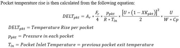

Calculation of Seal Windage Temperature Rise

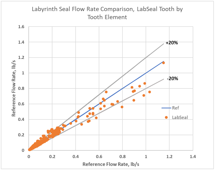

Labyrinth Seal TbT Validation
The labyrinth seal tooth by tooth results were compared to results from Tipton et al. (ref 7).
There are 705 labyrinth seal cases with a wide range of geometries and operating conditions.
Geometries
Number of teeth: 1, 3, 4, 5, 6, 10, 18
Step Height(in): -0.12, 0, +0.12
Honeycomb (in): Solid, 1/32, 1/16, 1/8
Tooth Slant Angle (deg): 0, 20, 40, 42.5
Tooth Wedge Angle (deg): 0, 10, 14, 15, 19
Tooth Spacing (in): 0.1, 0.177, 0.179, 0.25, 0.30, 0.354, 0.378, 0.626
Tooth Height (in): 0.1, 0.126, 0.135, 0.17, 0.25, 0.5
Tooth Tip Radius (in): 2.0, 2.26, 3.0, 3.36, 5.0, 7.63
Clearance (in): 0.004, to 0.061
Geometry Ratios
Pitch/Clearance: 4 to 156
Width/Clearance: 0.25 to 62.75
Width/Pitch: 0.031 to 0.67
Width/Honeycomb Size: 0.08 to 0.48
Clearance/Honeycomb Size: 0.04 to 0.65
Operating Conditions
Pressure Ratio: 1.04 to 6.8
Rotor Speed (RPM): 0, 13000, 20000, 30000
Element Leakage Flow Factor Settings
Figure 11.
Figure 12.
Statistics of the comparison based on:
%   E r r o r = F S   F l o w − T e s t   F l o w T e s t   F l o w * 100 MathType@MTEF@5@5@+= feaahqart1ev3aqatCvAUfeBSjuyZL2yd9gzLbvyNv2CaerbuLwBLn hiov2DGi1BTfMBaeXatLxBI9gBaerbd9wDYLwzYbItLDharqqtubsr 4rNCHbGeaGqiVu0Je9sqqrpepC0xbbL8F4rqqrFfpeea0xe9Lq=Jc9 vqaqpepm0xbba9pwe9Q8fs0=yqaqpepae9pg0FirpepeKkFr0xfr=x fr=xb9adbaqaaeGaciGaaiaabeqaamaabaabaaGcbaaeaaaaaaaaa8 qacaGGLaGaaiiOaiaadweacaWGYbGaamOCaiaad+gacaWGYbGaeyyp a0ZaaSaaa8aabaWdbiaadAeacaWGtbGaaiiOaiaadAeacaWGSbGaam 4BaiaadEhacqGHsislcaWGubGaamyzaiaadohacaWG0bGaaiiOaiaa dAeacaWGSbGaam4BaiaadEhaa8aabaWdbiaadsfacaWGLbGaam4Cai aadshacaGGGcGaamOraiaadYgacaWGVbGaam4DaaaacaGGQaGaaGym aiaaicdacaaIWaaaaa@591D@
Avg Mean Max Min Std_dev Count Within +/10% Within +/20%
10% 6% 59% -30% 14% 705 459 632
459 out of 705 test cases match within 10%.
