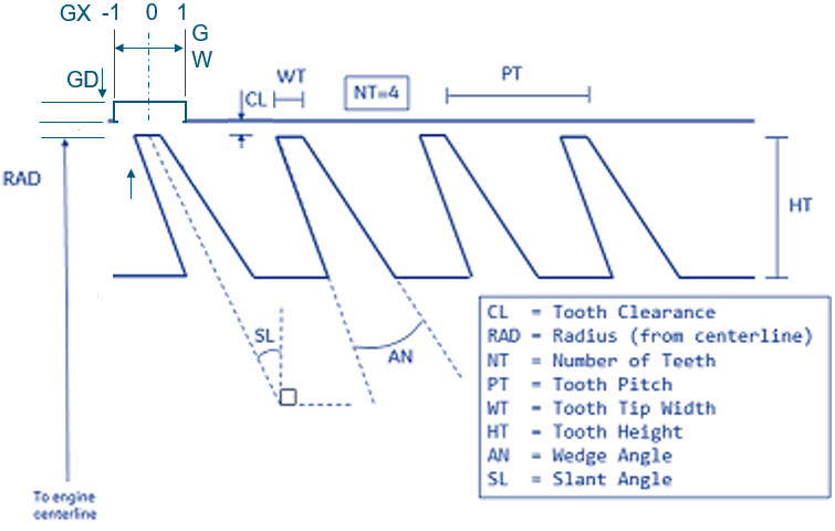

The figure below shows the geometric inputs. The seal clearance is the besides the geometric inputs the user needs to enter honeycomb information
A Vermes seal typically has the seal teeth rotating. This requires the user to enter an RPM reference condition in the Solution Panel.
Vermes Seal Inputs
Table of the inputs for the Vermes seal. See the image in the user interface to help understand geometric variables.
Vermes Seal Element Input Variables
Index UI Name (.flo label) Description
1 Seal Clearance (CL) Seal clearance .
2 Nominal Seal Radius or Inlet Radius (RAD) Nominal seal radius for a straight seal or the inlet radius for a stepped seal.
3 Number of Teeth (NT) Number of teeth in seal.
4 Seal Axial Pitch (PT) Seal axial pitch .
5 Tooth Tip Width (WT) Axial width of seal tooth tip.
6 Seal Tooth Height (HT)
Seal tooth height .
This variable influence only the windage calculated for a rotating seal.
7 Wedge Angle (AN) Angle between sides of a seal tooth .

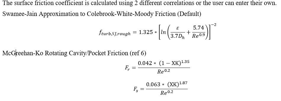

Friction and Windage – Rotor:
Friction Relation (FRIC_REL_R)
0: Swamee-Jain Approximation to Colebrook-White-Moody Friction (Default)
1: MacGreehan-Ko Rotating Cavity/Pocket Friction
5: Sultanian
-1: User supplies FRICF_STATOR, either constant value or calculated using controllers. See FRICF_STATOR details below.
27 Rotor Sandgrain Roughness (ROUGH_ROTOR) Roughness of the rotor surface. It is assumed to be a sand-grain type roughness, which is consistent with Colebrook-White-Moody.
28
Friction Multiplier (F_MULT_ROTOR)
Friction multiplier on Rotor is used if you want the friction curve to follow that same basic trend as Swamee-Jain or MacGreehan-Ko but your custom friction curve differs by a multiplication factor.
29
Friction Coefficient (FRICF_ROTOR)
Fanning Friction Coefficient on Rotor can be supplied as a constant value, or it can be calculated using a controller.
30
Total Rotor Surface Area (ASR)
Generally, ASR=0 and the rotor friction area is calculated from other geometric inputs such as tooth height, spacing, wedge angle, slant angle, etc. If you enter a non-zero value, your input will override the calculated area. Solver units are sq.in.
31
Friction and Windage – Stator:
Friction Relation (FRIC_REL_S)
5: Sultanian
32 Stator Sandgrain Roughness (ROUGH_STATOR) Roughness of the stator surface. It is assumed to be a sand-grain type roughness, which is consistent with Colebrook-White-Moody. Estimating a suitable roughness for a honeycomb surface is one challenge, but no advice can be given here.
33
Friction Multiplier (F_MULT_STATOR)
Friction multiplier on Stator is used if you want the friction curve to follow that same basic trend as Swamee-Jain or MacGreehan-Ko but your custom friction curve differs by a multiplication factor.
34
Friction Coefficient (FRICF_STATOR)
Fanning Friction Coefficient on Stator can be supplied as a constant value, or it can be calculated using a controller.
35
Total Land Surface Area (ASS)
Generally, ASR=0 and the rotor friction area is calculated from other geometric inputs such as tooth height, spacing, wedge angle, slant angle, etc. If you enter a non-zero value, your input will override the calculated area. This is especially useful for stepped seals, since the current Vermes Seal element does not have a step height input. However, it could be better to ignore the step height and rely on ETATOOTH – please see above. Solver units are sq.in.

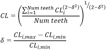

Table 1 Individual Tooth Clearances (CL_VALUES) There is an option to provide an array of individual clearance values, one for each seal tooth. The method uses a curve that is fitted to Tisarev, Falaleev, Vinogradov 2014 data, and computes an effective tooth clearance from the array of individual tooth clearance values. Solver units are inches.
The following equation is used to calculate and effective clearance for the entire seal.

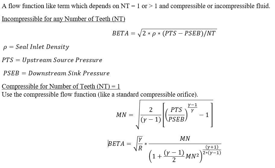

Flow Rate Calculation
For a seal with one tooth, KEMULT=1.0, and BETA is calculated using the flow function. See the BETA section for details.

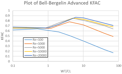

KFAC
3. Bell-Bergelin Advanced. Uses a table of KFAC vs WT/CL for several Reynolds numbers from ref. 3. Bilinear interpolation used to find KFAC. The Bell-Bergelin equation shown above matches the Re=10,000 curve. The Advanced option is more accurate for Re<10,000. Re is the annular orifice (tooth gap) Reynolds number and can be found in the *.res file.

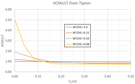

HCMULT
The honeycomb flow multiplier has five options.
  1. Auto method uses Tipton table for straight seals and Schramm equation for stepped seals. This is the default.
  2. Schramm Stepped Seal (Ref 4, Fig 12).
    H C M U L T = 1.0 + 0.0794 − 0.1208 * W T H C C L H C 2 MathType@MTEF@5@5@+= feaahqart1ev3aqatCvAUfeBSjuyZL2yd9gzLbvyNv2CaerbuLwBLn hiov2DGi1BTfMBaeXatLxBI9gBaerbd9wDYLwzYbItLDharqqtubsr 4rNCHbGeaGqiVu0Je9sqqrpepC0xbbL8F4rqqrFfpeea0xe9Lq=Jc9 vqaqpepm0xbba9pwe9Q8fs0=yqaqpepae9pg0FirpepeKkFr0xfr=x fr=xb9adbaqaaeGaciGaaiaabeqaamaabaabaaGcbaaeaaaaaaaaa8 qacaWGibGaam4qaiaad2eacaWGvbGaamitaiaadsfacqGH9aqpcaaI XaGaaiOlaiaaicdacqGHRaWkdaWcaaWdaeaapeGaaGimaiaac6caca aIWaGaaG4naiaaiMdacaaI0aGaeyOeI0IaaGimaiaac6cacaaIXaGa aGOmaiaaicdacaaI4aGaaiOkamaalaaapaqaa8qacaWGxbGaamivaa WdaeaapeGaamisaiaadoeaaaaapaqaa8qadaqadaWdaeaapeWaaSaa a8aabaWdbiaadoeacaWGmbaapaqaa8qacaWGibGaam4qaaaaaiaawI cacaGLPaaapaWaaWbaaSqabeaapeGaaGOmaaaaaaaaaa@5382@
  3. Stocker Straight (Ref 4, Fig 12)
    H C M U L T = 1.0 + 0.0794 − 0.1208 * W T H C C L H C 2 * e − 0.1725 C L H C ^ .6846 MathType@MTEF@5@5@+= feaahqart1ev3aqatCvAUfeBSjuyZL2yd9gzLbvyNv2CaerbuLwBLn hiov2DGi1BTfMBaeXatLxBI9gBaerbd9wDYLwzYbItLDharqqtubsr 4rNCHbGeaGqiVu0Je9sqqrpepC0xbbL8F4rqqrFfpeea0xe9Lq=Jc9 vqaqpepm0xbba9pwe9Q8fs0=yqaqpepae9pg0FirpepeKkFr0xfr=x fr=xb9adbaqaaeGaciGaaiaabeqaamaabaabaaGcbaaeaaaaaaaaa8 qacaWGibGaam4qaiaad2eacaWGvbGaamitaiaadsfacqGH9aqpcaaI XaGaaiOlaiaaicdacqGHRaWkdaWcaaWdaeaapeGaaGimaiaac6caca aIWaGaaG4naiaaiMdacaaI0aGaeyOeI0IaaGimaiaac6cacaaIXaGa aGOmaiaaicdacaaI4aGaaiOkamaalaaapaqaa8qacaWGxbGaamivaa WdaeaapeGaamisaiaadoeaaaaapaqaa8qadaqadaWdaeaapeWaaSaa a8aabaWdbiaadoeacaWGmbaapaqaa8qacaWGibGaam4qaaaaaiaawI cacaGLPaaapaWaaWbaaSqabeaapeGaaGOmaaaaaaGccaGGQaGaamyz a8aadaahaaWcbeqaa8qadaqadaWdaeaapeWaaSaaa8aabaWdbiabgk HiTiaaicdacaGGUaGaaGymaiaaiEdacaaIYaGaaGynaaWdaeaapeWa aeWaa8aabaWdbmaalaaapaqaa8qacaWGdbGaamitaaWdaeaapeGaam isaiaadoeaaaaacaGLOaGaayzkaaGaaiOxaiaac6cacaaI2aGaaGio aiaaisdacaaI2aaaaaGaayjkaiaawMcaaaaaaaa@666E@
  4. Tipton Straight (Ref 7, Fig 26). An HCMULT is calculated using bilinear interpolation of the curves shown here.

Choked Flow Calculation
For compressible gasses, the calculated seal mass flow is compared to the mass flow for choked flow through the last tooth. If the choked flow through the last tooth is less than the calculated seal mass flow, the choked flow is used. The equations for the choked flow calculation are:
m ˙ c h o k e = C d * A r e a l a s t − t o o t h * P l a s t − p o c k e t * f l o w _ f u n c t i o n c h o k e T t l a s t − p o c k e t MathType@MTEF@5@5@+= feaahqart1ev3aqatCvAUfeBSjuyZL2yd9gzLbvyNv2CaerbuLwBLn hiov2DGi1BTfMBaeXatLxBI9gBaerbd9wDYLwzYbItLDharqqtubsr 4rNCHbGeaGqiVu0Je9sqqrpepC0xbbL8F4rqqrFfpeea0xe9Lq=Jc9 vqaqpepm0xbba9pwe9Q8fs0=yqaqpepae9pg0FirpepeKkFr0xfr=x fr=xb9adbaqaaeGaciGaaiaabeqaamaabaabaaGcbaaeaaaaaaaaa8 qaceWGTbWdayaacaWaaSbaaSqaa8qacaWGJbGaamiAaiaad+gacaWG RbGaamyzaaWdaeqaaOWdbiabg2da9maalaaapaqaa8qacaWGdbGaam izaiaacQcacaWGbbGaamOCaiaadwgacaWGHbWdamaaBaaaleaapeGa amiBaiaadggacaWGZbGaamiDaiabgkHiTiaadshacaWGVbGaam4Bai aadshacaWGObaapaqabaGcpeGaaiOkaiaadcfapaWaaSbaaSqaa8qa caWGSbGaamyyaiaadohacaWG0bGaeyOeI0IaamiCaiaad+gacaWGJb Gaam4AaiaadwgacaWG0baapaqabaGcpeGaaiOkaiaadAgacaWGSbGa am4BaiaadEhacaGGFbGaamOzaiaadwhacaWGUbGaam4yaiaadshaca WGPbGaam4Baiaad6gapaWaaSbaaSqaa8qacaWGJbGaamiAaiaad+ga caWGRbGaamyzaaWdaeqaaaGcbaWdbmaakaaapaqaa8qacaWGubGaam iDa8aadaWgaaWcbaWdbiaadYgacaWGHbGaam4CaiaadshacqGHsisl caWGWbGaam4BaiaadogacaWGRbGaamyzaiaadshaa8aabeaaa8qabe aaaaaaaa@784D@
f l o w _ f u n c t i o n c h o k e = γ R 1 + γ − 1 2 γ + 1 1 − γ MathType@MTEF@5@5@+= feaahqart1ev3aqatCvAUfeBSjuyZL2yd9gzLbvyNv2CaerbuLwBLn hiov2DGi1BTfMBaeXatLxBI9gBaerbd9wDYLwzYbItLDharqqtubsr 4rNCHbGeaGqiVu0Je9sqqrpepC0xbbL8F4rqqrFfpeea0xe9Lq=Jc9 vqaqpepm0xbba9pwe9Q8fs0=yqaqpepae9pg0FirpepeKkFr0xfr=x fr=xb9adbaqaaeGaciGaaiaabeqaamaabaabaaGcbaaeaaaaaaaaa8 qacaWGMbGaamiBaiaad+gacaWG3bGaai4xaiaadAgacaWG1bGaamOB aiaadogacaWG0bGaamyAaiaad+gacaWGUbWdamaaBaaaleaapeGaam 4yaiaadIgacaWGVbGaam4Aaiaadwgaa8aabeaak8qacqGH9aqpdaGc aaWdaeaapeWaaSaaa8aabaWdbiabeo7aNbWdaeaapeGaamOuaaaaaS qabaGcdaGcaaWdaeaapeWaaeWaa8aabaWdbiaaigdacqGHRaWkdaWc aaWdaeaapeGaeq4SdCMaeyOeI0IaaGymaaWdaeaapeGaaGOmaaaaai aawIcacaGLPaaapaWaaWbaaSqabeaapeWaaSaaa8aabaWdbiabeo7a NjabgUcaRiaaigdaa8aabaWdbiaaigdacqGHsislcqaHZoWzaaaaaa qabaaaaa@5A78@
Where: C d = max 1.0   a n d   H C m u l t MathType@MTEF@5@5@+= feaahqart1ev3aqatCvAUfeBSjuyZL2yd9gzLbvyNv2CaerbuLwBLn hiov2DGi1BTfMBaeXatLxBI9gBaerbd9wDYLwzYbItLDharqqtubsr 4rNCHbGeaGqiVu0Je9sqqrpepC0xbbL8F4rqqrFfpeea0xe9Lq=Jc9 vqaqpepm0xbba9pwe9Q8fs0=yqaqpepae9pg0FirpepeKkFr0xfr=x fr=xb9adbaqaaeGaciGaaiaabeqaamaabaabaaGcbaaeaaaaaaaaa8 qacaWGdbGaamizaiabg2da9iaab2gacaqGHbGaaeiEamaabmaapaqa a8qacaaIXaGaaiOlaiaaicdacaGGGcGaamyyaiaad6gacaWGKbGaai iOaiaadIeacaWGdbGaamyBaiaadwhacaWGSbGaamiDaaGaayjkaiaa wMcaaaaa@49DE@
This accounts for the additional flow area if the honeycomb cell allows the seal to flow more than a smooth surface (HCMULT>1 if the clearance is small and HC size is large).

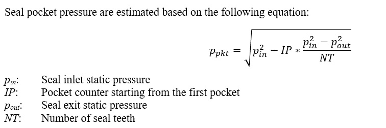

Calculation of Seal Pocket Pressure

Sultanian Friction (ref 9)
Rotor Surface: FR=0.070*β0.65Re0.2*|β-XK|0.65
Stator Surface: FS=0.063Re0.2*|XK|0.13

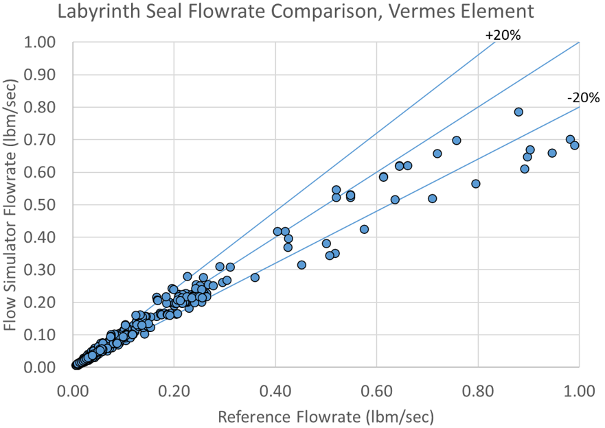

Vermes Seal Validation
The Vermes seal results were compared to results from Tipton et.al. (ref 7).
A total of 705 labyrinth seal cases using a wide range of geometries and operating conditions. The vermes seal element used all default leakage methods as shown here:
Figure 4.
Geometries
Number of teeth: 1, 3, 4, 5, 6, 10, 18
Step Height(in): -0.12, 0, +0.12
Honeycomb (in): Solid, 1/32, 1/16, 1/8
Tooth Slant Angle (deg): 0 , 20, 40, 42.5
Tooth Wedge Angle (deg): 0, 10, 14, 15, 19
Tooth Spacing (in): 0.1, 0.177, 0.179, 0.25, .30, .354, .378, .626
Tooth Height (in): 0.1, 0.126, 0.135, 0.17, 0.25, 0.5
Tooth Tip Radius (in): 2.0, 2.26, 3.0, 3.36, 5.0, 7.63
Clearances (in): .004, to .061
Geometry Ratios:
Pitch/Clearance: 4 to 156
Width/Clearance: .25 to 62.75
Width/Pitch: .031 to .67
Width/Honeycomb Size: .08 to .48
Clearance/Honeycomb Size: .04 to .65
Operating Conditions:
Pressure Ratio: 1.04 to 6.8
Rotor Speed (RPM): 0, 13000, 20000, 30000
Figure 5.
Statistics of the comparison based on:
%   E r r o r = F S   F l o w − T e s t   F l o w T e s t   F l o w * 100 MathType@MTEF@5@5@+= feaahqart1ev3aqatCvAUfeBSjuyZL2yd9gzLbvyNv2CaerbuLwBLn hiov2DGi1BTfMBaeXatLxBI9gBaerbd9wDYLwzYbItLDharqqtubsr 4rNCHbGeaGqiVu0Je9sqqrpepC0xbbL8F4rqqrFfpeea0xe9Lq=Jc9 vqaqpepm0xbba9pwe9Q8fs0=yqaqpepae9pg0FirpepeKkFr0xfr=x fr=xb9adbaqaaeGaciGaaiaabeqaamaabaabaaGcbaaeaaaaaaaaa8 qacaGGLaGaaiiOaiaadweacaWGYbGaamOCaiaad+gacaWGYbGaeyyp a0ZaaSaaa8aabaWdbiaadAeacaWGtbGaaiiOaiaadAeacaWGSbGaam 4BaiaadEhacqGHsislcaWGubGaamyzaiaadohacaWG0bGaaiiOaiaa dAeacaWGSbGaam4BaiaadEhaa8aabaWdbiaadsfacaWGLbGaam4Cai aadshacaGGGcGaamOraiaadYgacaWGVbGaam4DaaaacaGGQaGaaGym aiaaicdacaaIWaaaaa@591D@
Figure 6.
471 out of 705 test cases match within 10%
