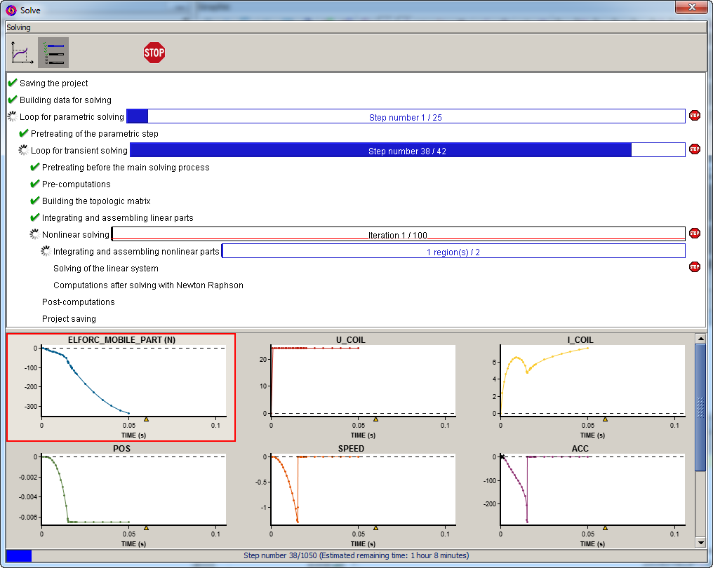

Advanced progress context
This context contains:
- A thumbnail for each quantity which can be displayed during the solving
- A representation of the solving algorithm with several progress bars
Results preview context
- A main viewer representing in large the selected quantity (red frame in the thumbnails below)
Manipulation of the window
The solving box is resizable vertically and horizontally.
- The size ratio of the different zones (main viewer / thumbnails) will remain proportional if the height of the window is resized.
- In the case of a resizing of the width, the size of the main viewer is stretched, on the other hand the dimensions of thumbnails do not change, but the number of thumbnails on the same line is adapted
- There is a movable separator between the main viewer and thumbnails which allows modifying the ratio between these 2 zones.

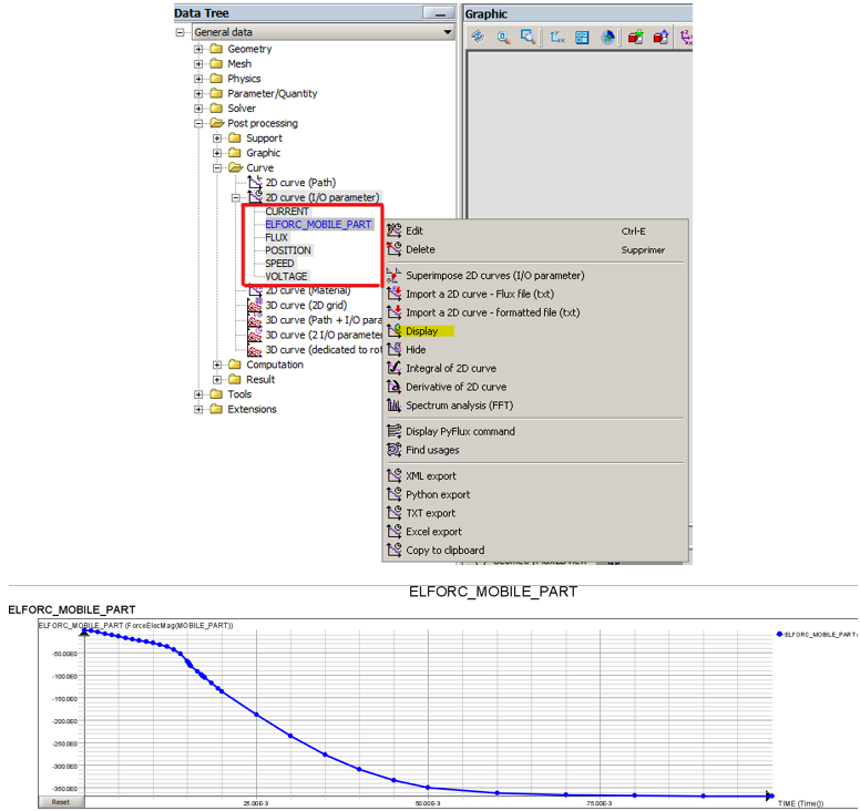

Life cycle
The solving window is persistent at the end of the solving. The user can thus analyze
the curves. To access the postprocessing context, the user must close this window by
clicking on the cross
The storage of all curves displayed during the solving process is done, one 2D curve (parameter I/O) by quantities are created and the user could redisplay it in the postrpocessing context.
Warning: Once the window is closed, it cannot be re-opened.
