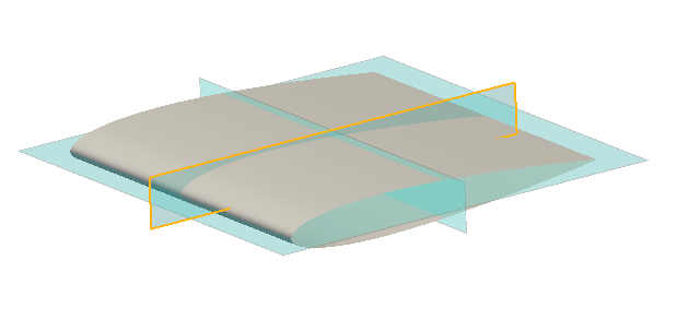

Select one of the three Cartesian planes in the modeling window to use as an intersection curve.
Reposition the intersection curve if needed.
- Drag the Move tool manipulators.
- Click X, Y, or Z to align to the global axes.

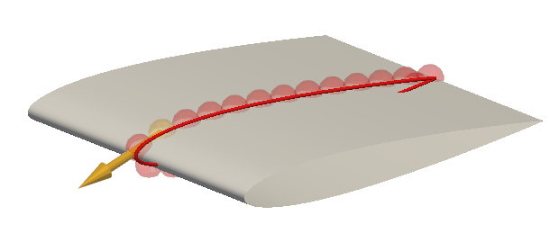

- Click Seeds on the guide bar.
Enter the amount of points to consider.
Toggle Enable resampling to change the points on the curve from being evenly spaced along the intersection line to being at the intersection of the infinite plane and the edges that it intersects.
Select the first point to display in the plot. Click the point again to toggle
the direction the direction in which subsequent points are plotted.

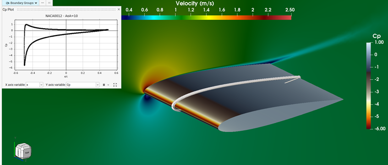

Figure 3.
- Click Calculate.
In the plot dialog, select the x and y axis variables then click
to define display properties.
Tip: Scroll to zoom in and out on the plot and right-click and drag to pan.Figure 4.
