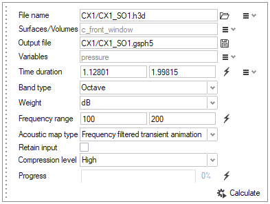

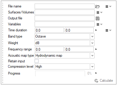

Define the surface- or volume-based signal processing attributes in the
dialog.
Figure 3. Input dialog for GSP (Hydrodynamic Acoustic Map focus)

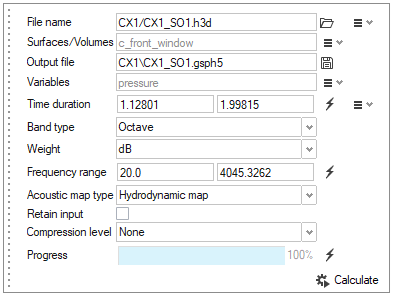

Load the data file of interest into the tool using the file browser icon,
Fields are populated with the data that is contained in the input source (.h3d). -
The following attributes are populated once the data is initially loaded.
Assign each of the attributes according to best-practice guidelines.
- File name
- Source data as provided from the solver (.h3d file) or the pre-processed compact form of the pressure/velocity vs. time signal (.gsph5 file).
- Surfaces/Volumes
- Surface or volume components that are sent to the GSP algorithm. Multiple components contained within the input source may be selected by entering the advanced selection context.
- Variables
- Input variables that define the input signal. Multiple variables may be selected and processed at the same time.
- Time duration
- Beginning and ending time values in seconds. The fields may be
modified based to control the number of records considered during
the calculation. Auto-calculate
can be utilized to redefine the
original time-series bounds. - Band type
- Output band summation option. Single band provides a single dB map comprised of SPL from the full frequency range. Octave (fractional octave) provides a frequency dependent dB map for each of the Nth octave bands, with N=1, 3, 12 that fall within the frequency range of interest. The octave band center frequency is reported within the output file.
- Weight (Scaling)
- Decibel scaling for dB (default), dBA or dBC. All data in the dB map
will be weighted according to your selection of weight. Provides dBA
weight for interpreting dB maps associated with the range of human
hearing.Note: dBA ~= dB at a frequency of 1kHz.
- Frequency range
- Minimum and maximum cutoff frequency to be displayed in the output
results. Auto-calculate
original supported cutoff frequency bounds.Note: The minimum value is set to resolve the minimum frequency that is supported by ~4 cycles of the transient period, the maximum is set to the Nyquist Frequency.

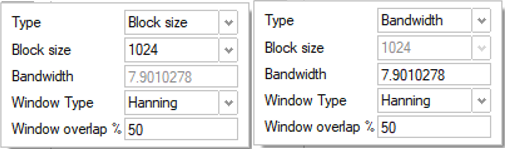

in the main menu dialog. Select the FFT parameters through the first menu, as
shown in Figure 4.
Figure 4. FFT parameters for the GSP calculation
- Type
- Modifies the subsequent selection of the FFT bandwidth for
windowing.
When Type=Block size, the Block size enumerated list is accessible, defaulting to 4096 records. The associated Bandwidth for that Block size is automatically calculated and presented to you.
When Type=Bandwidth size, the Bandwidth real number is accessible, defaulting to the bandwidth associated with a Block size of 4096 records. When the Bandwidth is modified, the associated Block size is automatically calculated and presented to you.
- Window Type
- Windowing algorithm used to reduce spectral leakage that may be present within the input pressure signal. Hanning, Hamming and Blackman are available.
- Window Overlap (%)
- Define the percentage overlap for each window used during the FFT of the input pressure signal.
Review the data contained within the input source through the second
menu.
The menu shows the Time range (seconds), Record length (samples), Data Frequency (Hz) and Time step (seconds).
Figure 5. Source data parameters, non-modifiable
Once the parameters have been defined, click
Calculate.

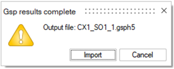

This performs the calculation in a sub-process, allowing you to return to the UI and prepare any additional post-processing content. During the calculation, a status indicator is updated with the progress of the sub-process. To query the status of the calculation, press the
icon.Once the calculation is complete, you are presented with the option to load the data into the post-processing session, as shown in Figure 6. Multiple datasets may be loaded into the session at once if required.
Note: Once the calculation has been completed, the definition for the GSP is stored in session, accessible in the Post Browser for future inspection.Figure 6. GSP progress bar and results complete, load data into the post-processing session

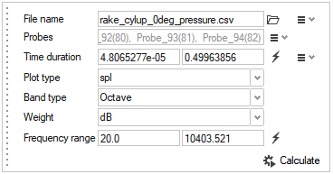

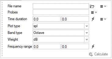

Define the point probe-based signal processing attributes in the dialog.
Figure 11. Input dialog for GSP (Point Probe focus)
Fields are populated with the data that is contained in the input source (.csv). -
(Figure 12).
- File name
- Source data as provided from the solver (.csv file).
- Probe selection
All, individual, or a subset of probes (read from the header names) for 1D processing. The advanced selection context may be used to chose specific probes.
- Time duration
original time-series bounds. - Plot type
- Define output plot type. Sound Pressure Level (SPL) or Power Spectral Density (PSD).
- Band type
- Output band summation option. Narrowband provides the full spectrum of requested frequency range output at the data source sampling frequency. Octave (fractional octave) provides a frequency dependent dB map for each of the Nth octave bands, with N=1, 3, 8, 12 that fall within the frequency range of interest. The octave band center frequency is reported for the computed bands.
- Weight
- Decibel weighting for dB (default), dBA or dBC. All data in the dB
map will be weighted according to your selection of weight. Provides
dBA weight for interpreting dB maps associated with the range of
human hearing.Note: dBA ~= dB at a frequency of 1kHz.
- Frequency range
Figure 12. Populated input dialog for GSP (Point Probe focus)
