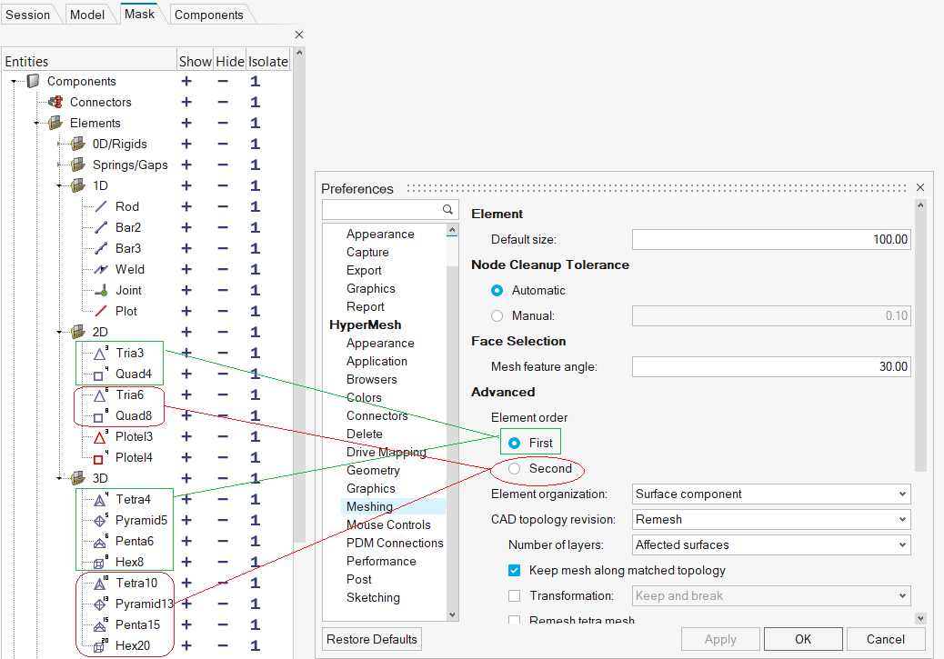

By default, first order elements are created. In order to create second order elements, set the meshing element order preference to Second.Figure 5.
