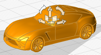

Use the Move tool to position the car inside of the wind tunnel.
- In the Model Browser, click the top-most assembly to select the entire car.
From the Home group, click the
Move tool.
The Move tool will initially be positioned at the centroid of selected entities.Figure 2.

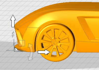

Click a graphical manipulator, and then do one of the following:
- Drag the entity or graphical manipulator to translate or rotate entities in the selected direction(s).
- Enter a precise value in the microdialog and press Enter.
- Press Ctrl and select two locations to align an axis to a vector or three locations to align an axis to a plane normal.
Note: The Ctrl + click action is valid only for translation and rotation manipulators.To Do This Translate along an axis Click the X, Y, or Z arrow. Figure 3.
Translate along a plane Click the XY, XZ, or YX plane square. Figure 4.
Translate freely in 3D space Click and drag from the origin of the Move tool. Figure 5.
Tip: Use the icons in the microdialog to align the tool to a part or the global axes.Rotate around an axis Click a curved arrow. Figure 6.
