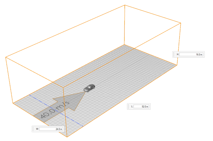

Use the Edit Tunnel tool to define the size of the wind tunnel.
From the Setup ribbon, click the Edit Tunnel tool.
Edit the wind tunnel's height, width, and length in the microdialogs that appear in the modeling window.
Edit the inflow velocity and tunnel extent properties in the modeling window.

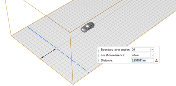

- Optional: Select the boundary layer suction line in the modeling window and turn the boundary layer suction off in the microdialog.
- Optional: Select the boundary layer suction line in the modeling window and define the location reference in the microdialog.
Edit the boundary layer suction by selecting the boundary layer suction line in
the modeling window and completing one of the
following:
- Enter a distance value in the microdialog.
Figure 3.

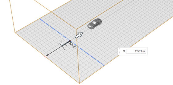

- Click
in the microdialog and drag the boundary layer
suction line.
Figure 4.

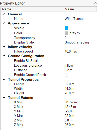

- Optional:
Ground Configuration properties (among others) can be defined in the
Property Editor panel.
Figure 5.
