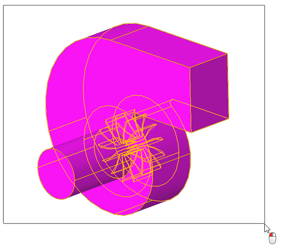

Using window selection, draw a box around the entire model.
Both the centrifugal blower and the housing solids are selected.

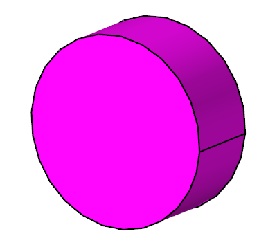

Hide the housing solid.
- Set the entity selector to Solids.
- Select the centrifugal housing.
- Right-click and select Hide form the context menu or press H.
Only the solid for the centrifugal blower displays in the modeling window.Figure 10.

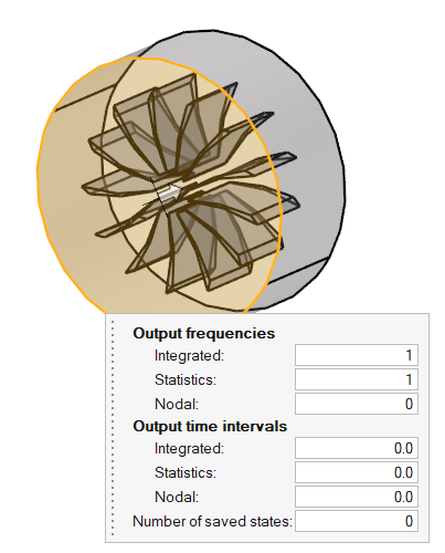

From the Flow ribbon, click the Reference Frame tool.
Figure 11.

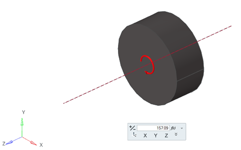

- Make sure the Include bounding surfaces option is active on the guide bar.
Select the solid in the modeling window.
Bounding surfaces are automatically selected.

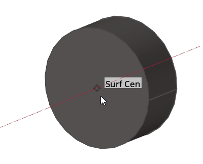

- On the guide bar, click Axis.
Define the axis of rotation.
to execute

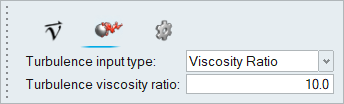

- In the microdialog, click the Turbulence tab.
- Set the Turbulence input type to Viscosity Ratio.
Set the Turbulence viscosity ratio to 10.
Figure 16.

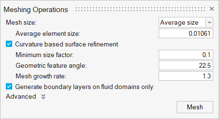

From the Mesh ribbon, click the
Volume tool.
Figure 20.
The Meshing Operations dialog opens.Note: If the model has not been validated, you are prompted to create the simulation model before running the batch mesh. - Check that the Average element size is 0.01061.
Accept all other default parameters.
Figure 21.
Click Mesh.

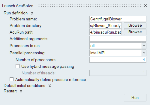

The Launch AcuSolve dialog opens. - Set the Parallel processing option to Intel MPI.
- Deactivate the Automatically define pressure reference option.
Leave the remaining options as default and click
Run to launch AcuSolve.

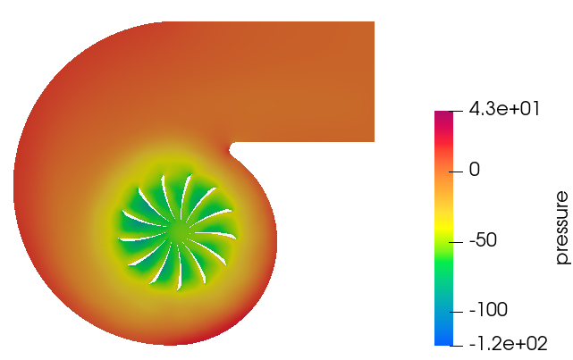

Click the Slice Planes tool.
Figure 27.

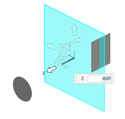

- Select the x-y plane in the modeling window.
and move the plane along its normal direction a distance of
-0.07.
Figure 28.
- Press Esc to exit the Move tool.
In the slice plane microdialog, click
to
create the slice plane.

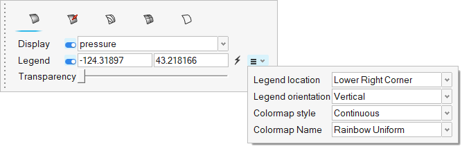

- In the display properties microdialog, toggle the Legend radio button.
Click
and set the Colormap Name to Rainbow
Uniform.
Figure 29.

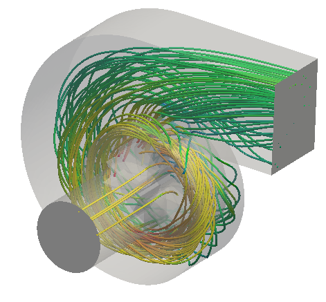

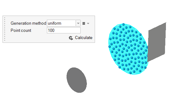

- On the guide bar, click Seeds.
- In the microdialog, set the Generation method to Uniform and set the Point count to 100.
Click Calculate.
Figure 33.
- In the display properties microdialog, set the Display to Velocity and set the Colormap Name to Rainbow Uniform.
to execute
- In the Post Browser, show the Auto boundary condition, then right-click on Auto and select Edit.
- In the microdialog, adjust the transparency slider until you can see the velocity streamlines.
Click
on the guide bar.
Figure 34.
