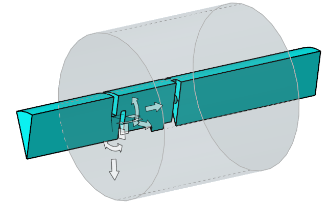

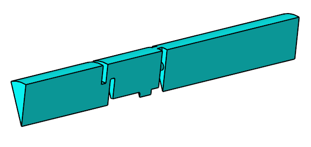

The problem to be addressed in this tutorial is shown schematically in Figure 1. It consists of a cylindrical pipe containing water that flows past a check valve with a shutter attached to a virtual spring (not included in the geometry). The inlet pressure varies over time and the movement of the shutter will be determined as a function of the balance of the fluid forces against the reactive force of the spring. The problem is rotationally periodic at 30° increments about the longitudinal axis, and it is assumed that the resulting flow is also rotationally periodic, allowing for modeling with the use of a wedge-shaped section. For this tutorial, a 30° section of the geometry is modeled, as shown in the figure. Modeling a portion of an rotationally periodic geometry leads to reduced computation time while still providing an accurate solution.
The pipe has an inlet diameter of 0.08 m, and is 0.3 m long. The check-valve assembly is 0.085 m downstream of the inlet. It consists of a plate 0.005 m thick with a centered orifice 0.044 m in diameter and a shutter with an initial position 0.005 m from the opening, simulating a nearly closed condition. The shutter plate is 0.05 m in diameter and 0.005 m thick. The shutter plate is attached to a stem 0.03 m long and 0.01 m in diameter. The mass of the shutter and stem is 0.2 kg and its motion is affected by a virtual spring with a stiffness of 2162 N/m. The motion of the valve shutter is limited by a stop mounted on a perforated plate downstream of the shutter.

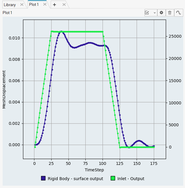

For this case, the transient behavior of interest occurs in the time it takes for the pressure to ramp up and ramp back down, which is given by the transient pressure profile. To allow time for the spring to recover, additional time will be simulated. For this tutorial, 0.1 s is added after the pressure drops back to initial conditions, for a total duration of 0.35 s.
Another critical decision in a transient simulation is choosing the time increment. The time increment is the change in time during a given time step of the simulation. It is important to choose a time increment that is short enough to capture the changes in flow properties of interest, but does not require unnecessary computation time.
The change in inlet pressure from initial conditions to maximum occurs over 0.048 s. A time increment of 0.002 s would allow for excellent resolution of the transient changes, without requiring excessive computational time.

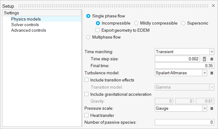

Under the Physics models setting:
- Set Time marching to Transient.
- Set the Time step size to 0.002 and the Final time to 0.35.
- Select Spalart-Allmaras as the Turbulence model.
Figure 9.

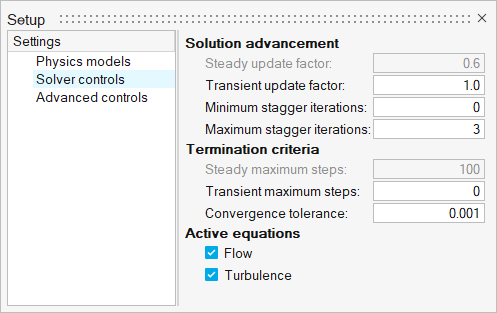

Click the Solver controls setting and set the Maximum
stagger iterations to 3.
Figure 10.

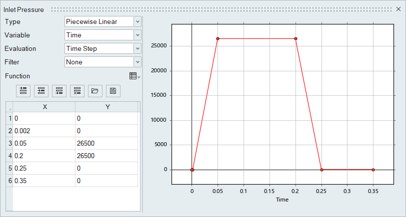

Create a Multiplier Function for the Inlet Pressure
From the Flow ribbon, click the arrow next to the
Setup tool set, then select Multipliers.
Figure 11.
Click
in the
Multiplier Library dialog.

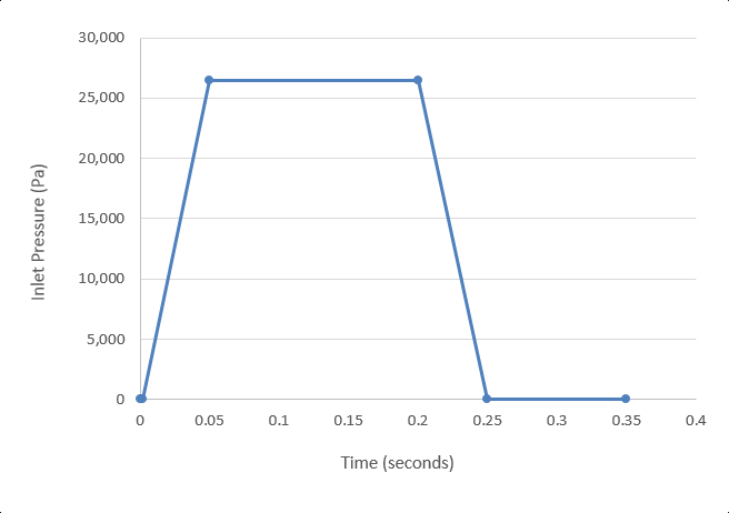

- In the multiplier creation dialog, change the name of the multiplier function to Inlet Pressure by clicking on the top-left corner.
- Set the Type to Piecewise Linear.
- Verify that the Variable is set to Time and Evaluation is set to Time Step.
Click
four
times to add four rows to the bottom of the table.
Enter the table values according to the image below.
Figure 12.

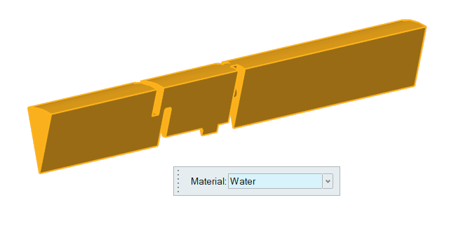

Assign Material Properties
Figure 13.
Click anywhere on the pipe geometry.
The entire geometry is highlighted.
Figure 14.
- In the microdialog, select Water from the Material drop-down menu.
On the guide bar, click
to execute
- Save the model.

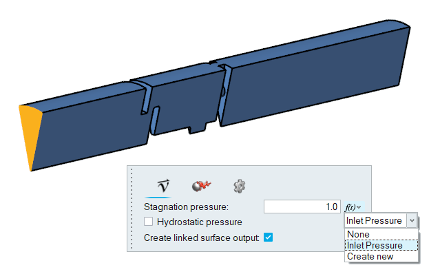

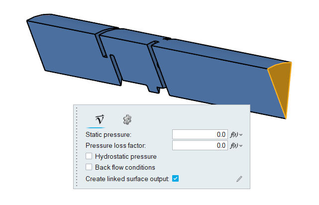

From the Flow ribbon, Pressure
tool group, click the Stagnation Pressure tool.
Figure 15.
- In the modeling window, click on the inlet surface, as shown in Figure 16.
- In the microdialog, enter a value of 1 N/m2 for the Stagnation pressure.
Click the Multiplier function drop-down and select the function
Inlet Pressure from the list.
Figure 16.

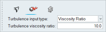

Click the Turbulence icon the microdialog, set the
Turbulence input type to Viscosity Ratio, and the enter a
value of 10 for the Turbulence viscosity ratio.

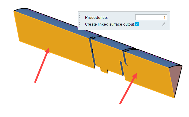

Select the two surfaces shown in the figure below.
Figure 21.
to execute the command and remain in the
tool.
- In the Boundaries legend, rename Symmetry to Front_symmetry.

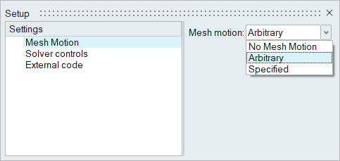

Set Up Motion
In this step, you will activate the mesh motion and define the rigid body motion for the valve wall. Then, you will define the mesh displacement boundary conditions for the symmetry surfaces.
Define the Mesh Motion Type
From the Motion ribbon, click the Settings tool.
Figure 23.
In the Setup dialog, change the Mesh motion to
Arbitrary.
Figure 24.

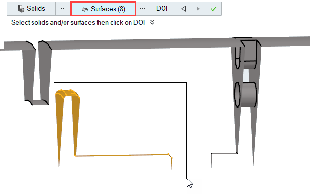

Define Rigid Body Motion
From the Motion ribbon, click the Rigid Body tool.
Figure 25.
- On the guide bar, activate the Surfaces selector by clicking on it.

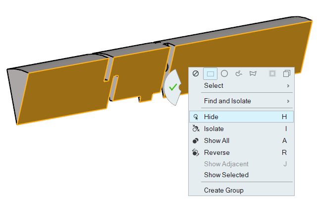

For convenience, hide the Front_symmetry and Back_symmetry faces in the
modeling window by selecting the four surface and
then pressing H on the keyboard or by right-click and
selecting Hide from the context menu.
Figure 26.

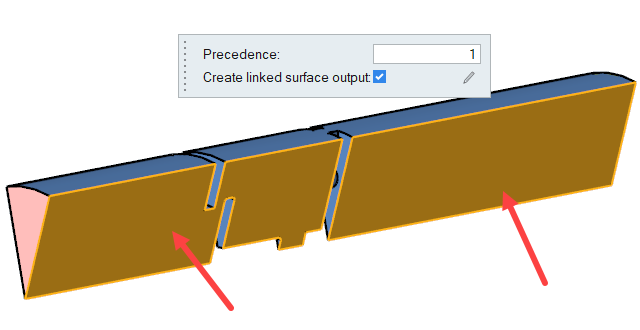

Select the valve wall surfaces, shown in the figure below, by using box
selection (hold and drag the left mouse button).
The number of surfaces selected should be 8, which will show on the guide bar.
Figure 27.

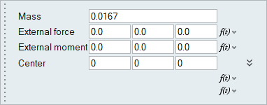

- On the guide bar, click on DOF then click anywhere on the valve wall surfaces in the modeling window.
In the microdialog that appears, enter the following
values:
- Mass: 0.0167 kg
- Center: (0, 0, 0)
Figure 28.

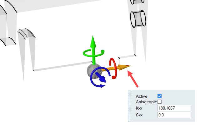

- Click on the X-displacement arrow in the modeling window.
180.1667 kg/sec2 for Kxx, the stiffness of
the spring.
Figure 29.

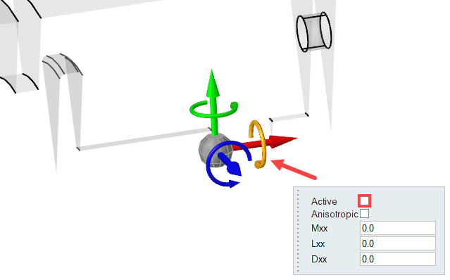

Click on the X-rotation arrow and de-activate it.
Figure 30.
Similarly, click on the remaining four arrows (Y-displacement, Y-rotation,
Z-displacement, and Z-rotation) and de-activate them.
This will ensure that the valve body translates only in the x-direction.

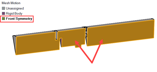

From the Motion ribbon, click the Planar Slip tool.
Figure 31.
- Select the two front symmetry surfaces shown in Figure 32.
In the Mesh Motion legend, rename Planar Slip to
Front_symmetry by double-clicking on the name.
Figure 32.

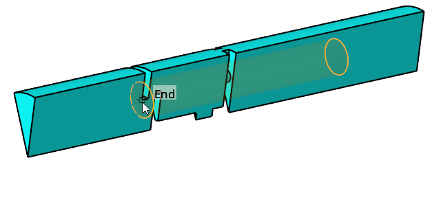

Define the Zone Mesh Controls
From the Mesh ribbon, Zones
tool group, click the Cylinder
tool.
Figure 33.
In the modeling window, hover the mouse around the
point shown in the figure below. When the preview cylinder zone is parallel to
the axis of the pipe, click on the model near the point shown below.

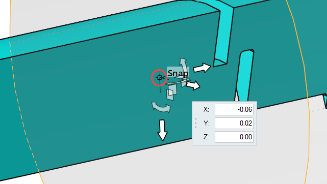

This point will be the center of the front face of the cylinder. In the next few steps you will edit the co-ordinates of this point manually.
Figure 34.
Move the mouse cursor away from the center and then click again.
A preview of the zone should be displayed on the screen along with the manipulator. The manipulator allows you to modify the location and orientation of the zone.
Figure 35.

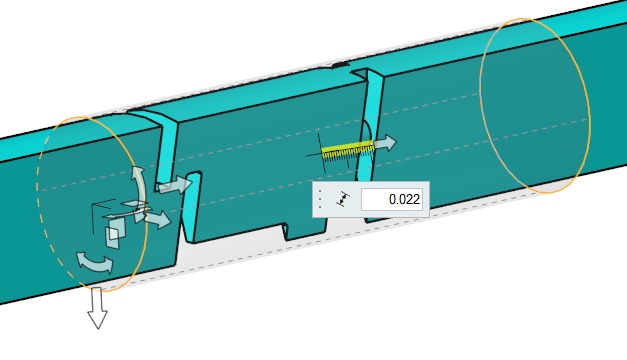

Click the center of the manipulator and enter the following coordinates for the
center (-0.06, 0.02, 0)
Figure 36.
Double-click on the cylindrical surface of the zone and enter
0.022 m as the radius of the cylinder.

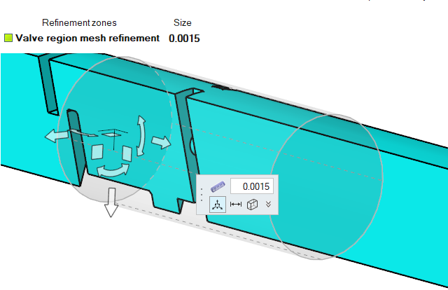

Double-click on the base of the cylinder and enter 0.1 m
as the height of the cylinder.
Figure 38.
- Click anywhere in the empty space in the modeling window.
- Enter a value of 0.0015 m for the mesh size in the microdialog.
In the Refinement zones legend, rename the zone to Valve region mesh
refinement.
Figure 39.

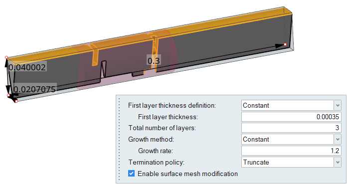

From the Mesh ribbon, click the Boundary Layer tool.
Figure 40.
Right-click in the modeling window and go to .
All the wall surfaces should be highlighted and a dialog for BL specification appears.
Enter the following values in the dialog:
- First layer thickness: 0.00035
- Total number of layers: 3
- Growth method: Constant
- Initial growth rate: 1.2
- Termination policy: Truncate
- Activate Enable surface mesh modification.
Figure 41.

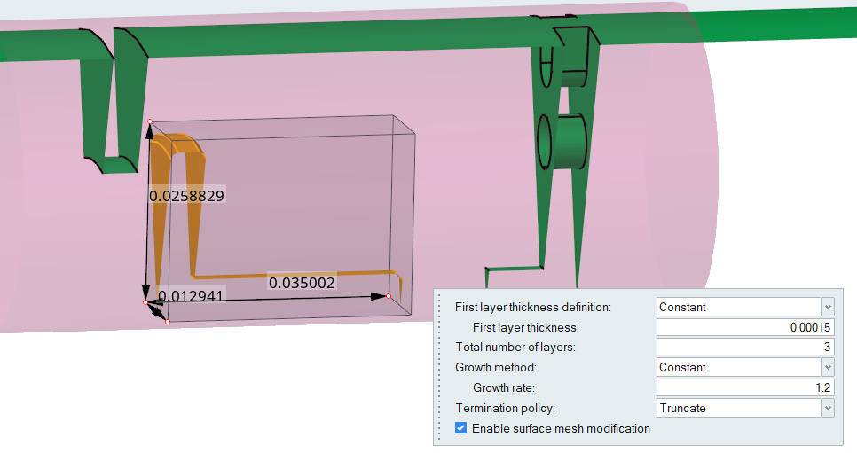

- In the next few steps, you will define the boundary layer mesh control for the valve walls. For convenience, hide the front and back symmetry faces.
- Select the valve wall surfaces using the box selection method.
In the dialog that appears, enter the following values for the BL
specification:
- First layer thickness: 0.00015
Figure 42.

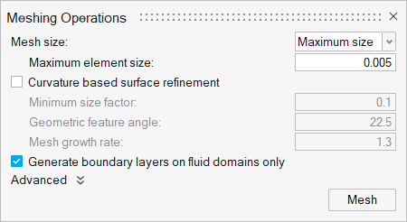

Generate the Mesh
Volume tool.
Figure 45.
- In the Meshing Operations dialog, set the Mesh size option to Maximum size and set the Maximum element size to 0.005.
- Deactivate Curvature based surface refinement.
Click Mesh to generate the mesh.

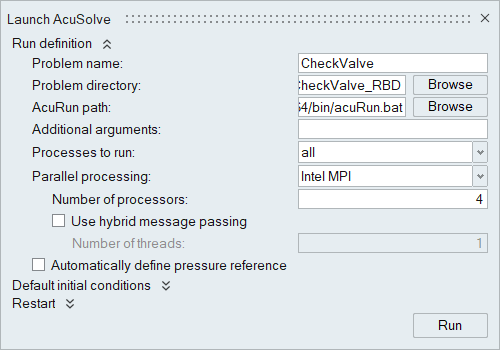

Launch AcuSolve
Figure 49.
- Set the Parallel processing option to Intel MPI.
- Deactivate the Automatically define pressure reference option.
Leave the remaining options as default and click
Run to launch AcuSolve.

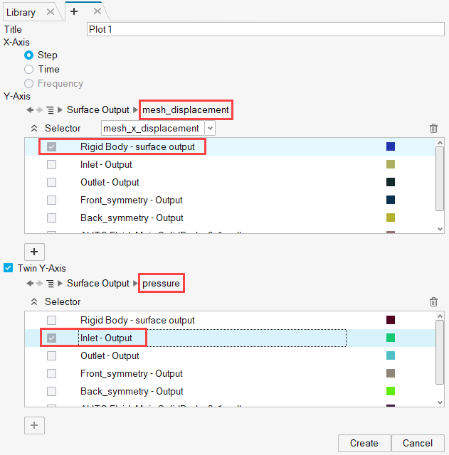

Monitor Results
From the Solution ribbon, click the Plot tool.
Figure 51.
Click
next to the Library tab.
Keep the X-axis set to Step. For the Y-axis, click the
tree browser
and select
mesh_displacement under Surface Output.
mesh_x_displacement is selected by default for the coordinate direction. - Check the box for Rigid Body - surface output under Selector.
- Check the box for Twin Y-Axis.
- Click the tree browser for the second Y-axis and select pressure under Surface Output.
Check the box for Inlet - Output under Selector.
Figure 52.
Click Create.
Figure 53.

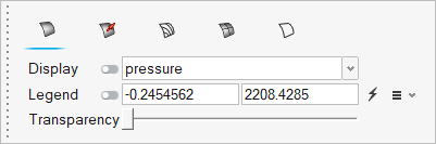

- In the Post Browser, right-click on Front_symmetry and select Isolate.
- Right-click on Front_symmetry once more and select Edit.
- In the display properties microdialog, set the display to velocity.
- Activate the Legend toggle and set the max velocity to 6.0.

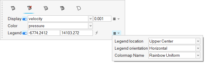

- Click the Vector Display tab.
- Turn the Display on, set the variable to velocity, and the value to 0.001.
- Set the Coloring to pressure.
Activate the Legend toggle and click
to reset the range.
Click
, set the Legend location to Upper
Center, the Legend orientation to
Horizontal, and the Colormap Name to
Rainbow Uniform.
Figure 60.
