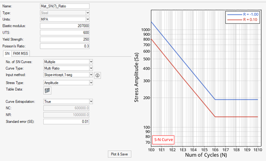

Multi Ratio Curves
Multiple stress life curves are defined at different values of stress ratio.
Select Input Method.
Options:
- Stress Intercept, 1-seg (multiple single sloped SN curves with respect to stress ratio)
- Stress Intercept, 2-seg (multiple two sloped SN curves with respect to stress ratio)
- XY Data (Xi, Yi data representing multiple SN curves with respect to stress ratio)
- Select Stress Type to select SN curve based on Amplitude/ Range/ Maximum Stress (Max).

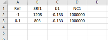

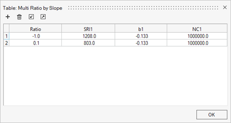

Table Data: Input Table of single sloped SN curves with respect to stress
ratio.
Figure 2. Example of CSV Format
Note: Alternately, multiple .csv files of Stress Ratio SN curves can be imported.Figure 3. CSV Format of Two Slope Multiple Stress Ratio SN Curves

- Select Curve Extrapolation as True.
If XY Data curve:
NC : Fatigue transition point. After this point, fatigue strength is offset by the surface correction factor. Before this point, fatigue strength is proportionally reduced. (Default = 60000)
NFl : Endurance limit. Number of cycles at which damage can be considered zero. (Default = 100000000)
- Set SE to 0.0 to define Standard Error of log(Stress).

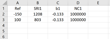

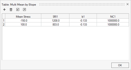

Table Data: Input Table of single sloped SN curves with respect to mean
stress.
Figure 5. Example of CSV Format
Note: Alternately, multiple .csv files of Stress Ratio SN curves can be imported.Figure 6. CSV Format of Two Slope Multiple Mean Stress SN Curves

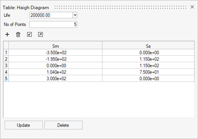

Select Table Data: Input Life and the number of point and click
Enter Sm vs Sa table and click Update.
Figure 8. Example of CSV Format
Note: Alternately, import of CV table.Figure 9. CSV Format of a Single Haigh Diagram
