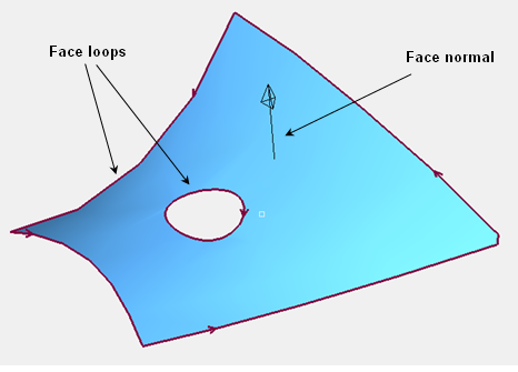

Created face must have at least one loop that defines its external boundary in parametric space.
If the function succeeds, the return value is true. If the function fails, the return value is false. To get extended value information, call HM_ExtAPI::GetLastErrorCode().

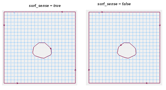

In parametric space, the direction of loops depends on geometric normal use defined by the parameter surf_sense. In case if the value of the parameter surf_sense is true then the face normal is oriented in the same direction as geometric surface normal and the "face on the left" rule applies in parametric space as well. The external loop of the face is oriented counter clockwise while all internal loops are oriented clockwise.

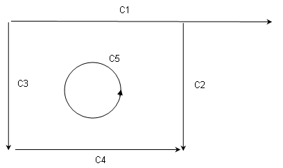

The curves C1, C2, C3, C4 are straight lines, for which the segments corresponding to parametric range 0 … 1 are shown. The curve C5 is a circle with angular parametric range 0… 2π.
That is, your intent is to create a face with the normal oriented in the same direction as the normal of geometric surface, and you want to create two loops. Note also that your intent is to split the internal circular loop into two edges.
You will need to provide arrays with curve parameters (curve_start_params and curve_and_params) because you need to cut the curves C1 and C5. You also will need to provide an array of curve direction flags because the curves C5, C1 and C2 have direction opposite to the direction of the loops that you need to have as a final result.
| number_of_loops | 2 |
| loop_coedge_counts | 4, 2 |
| loop_coedge_curves | C4, C2, C1, C3, C5, C5 |
| curve_start_params | 0, 0, 0, 0, π, 0 |
| curve_end_params | 1, 1, 0.7, 1, 2π, π |
| coedge_curve_dirs | true, false, false, true, false, false |
| surf_sense | true |
