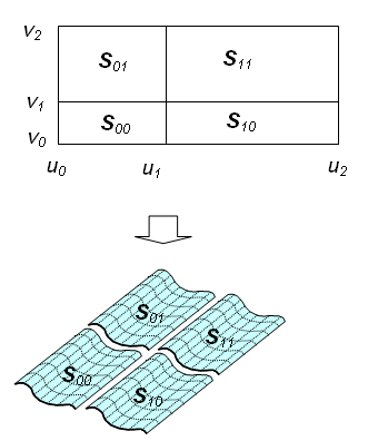

Subdivision of parametric space of the composed surface is defined by a set of grid parametric values for U parameter {uα} with index α taking the values in the range 0 … N and N is the number of patches in U parametric direction, and a set of grid parametric values for V parameter {vβ} with index β taking values in the range 0 … M and M is the number of patches in V parametric direction. For parametric values U and V such that
uα ≤ U ≤ uα+1 and vβ ≤ V ≤ vβ+1
the point on the composed surface is calculated as
S(U, V) = Sαβ(u, v)
where "local" patch parameters u and v are obtained by mapping from "global" parameters U and V using grid parametric values and patch parametric range values as
u = uαβ, 0 + (uαβ, 1 - uαβ, 0) (U - uα) / (uα+1 - uα)
v = vαβ, 0 + (vαβ, 1 - vαβ, 0) (V - vβ) / (vβ+1 - vβ)
