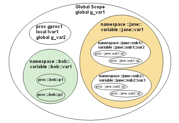

Namespaces provide a means of organizing procedures and variables in Tcl.
A global procedure acts just like any function within Tcl. A global procedure can be called from a namespace without any need to import or otherwise localize the procedure. A procedure within a namespace is local to the namespace unless it is explicitly called or the procedure is exported from the namespace. The global scope is also designed such that any variables defined outside of a procedure or a namespace are automatically in the global scope. To access a global variable in a local scope, such as a procedure or namespace, you will need to use the global command. As a script grows and as the number of scripts running simultaneously increases, the ability of the developer to avoid conflict between the names of procedures and variables defined in the global scope decreases.
