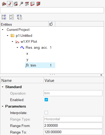

Note: From the Plot Browser, select the edited curve(s) to view the action performed and its related data.Figure 4.
Tip: To display the Edit guide bar from the Plot Browser, select a curve, right-click and select Edit Curves. -
