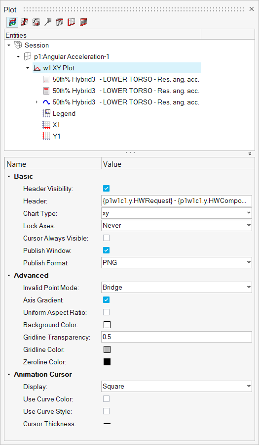

The HyperGraph Plot Browser is located in the tab area sidebar and allows you to view the HyperGraph plot structure.
The Plot Browser tools allow you to search, display, and edit
plot data within the current session. From the Plot Browser, you
can select entities one at a time or several simultaneously using common selection
techniques. You can also use the Plot Browser's
context-sensitive menus to select entities. Many of the operations found in the
HyperGraph panels can be performed in the Plot Browser, thus allowing you to modify your plot and curve
properties in one location. Some of these operations include:

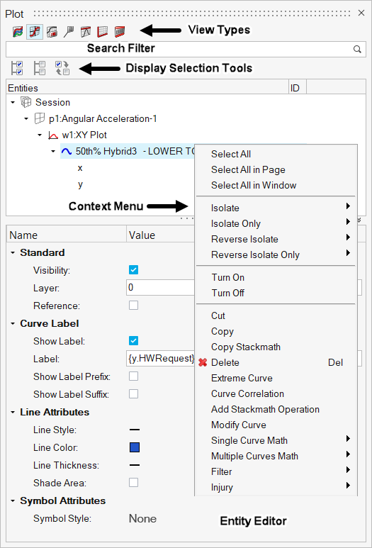

The Plot Browser can be turned on or off using the
menu option. A check mark indicates that the Plot Browser is activated for display in the tab area.
Note: Click and drag the Plot Browser to reposition
it elsewhere in the interface.
The following options can be used to change the display state of various entities in the Plot Browser tree.
Select All- Selects all entities shown in the tree.
Select None- Clears all entity selections shown in the tree.
Reverse Selection- Reverses the state of the items in the tree (displays the hidden and hides the displayed).
